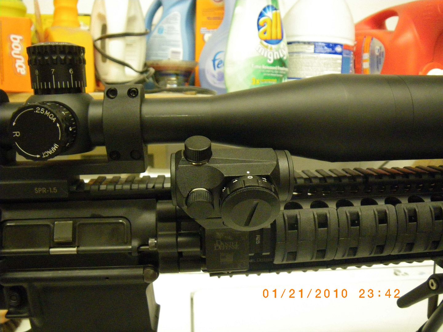

    I have a Primary Arms blem model sights on my Larue in a Larue Off set mount and on my GAP .308. Both sights have done fine so far. These are fun rifles for me and they are close range back ups to Nightforce scopes. The issues I have with the Primary Arms optics is as follows. The dot is bigger than advertized (about 7moa to my eyes) and the adjustments are very coarse. Meaning they are not 1/2 moa clicks. Not sure how far they are but its more than 1/2 moa by a long shot. I even installed one of these on a .308 carbine I sold a friend of mine. My opinion is they are fine for range guns but if this is a serious weapon get
