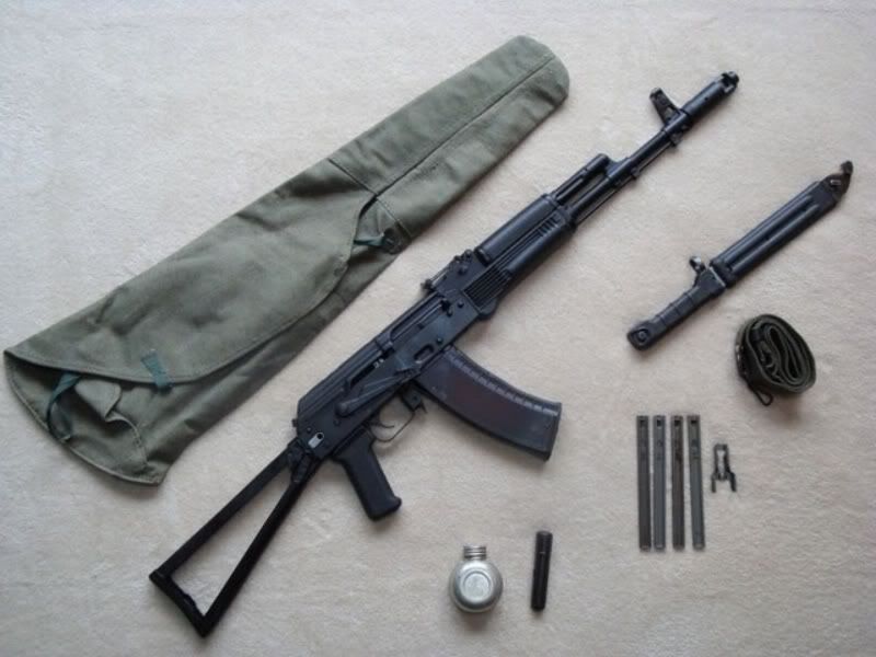

  6. #66
    Jul 2009
    2,177
    13 (100%)
    Quote Originally Posted by fhpchris View Post
    Both those are cool guns.... but as far as length goes...
    Stock folded length - 27.2
    16 inch barrel Krinks are even shorter...
    That said, I would love to own a 8 inch 6.8 SPC LWRC PSD upper for my AR.
    Yep, you nailed it with the AK. If you're aiming for a "short" weapon with a decent barrel length, a piston-based weapon with a folding stock is the way to go. An AK would be the easiest route...
