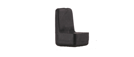

    A few days ago I was examining an M4 belonging to one of the team guys that we work with. He had an "accucrap" in his lower. It was almost split in half. When I showed him he said, "damn that could have come apart in my lower and caused problems". He promptly threw it away.
    They don't serve a purpose other than to make people believe that they are solving a problem that doesn't exist.

    if the Ar needed a Accu-wedge: ,Stoner would have put one there
    I would Not worry to much about it.
    What Upper and what Lower Are you Using ?

    Stick a loaded mag in the rifle and see how much wobble you have.Even a empty mag tightens up the wobble in my AR's.
    If you want to try something to remove a bit of wobble,get a set of the Armalite NM oversized pivot and take down pins and see what that does for you.
    Beyond that I'd avoid the accuwedges and the like products.I cut them down and used them for years on my NM and varmint guns without seeing one fail or come apart.But I have seen the wedges flip up out of their seat when the upper was opened and end up in the FCG if your not paying attention.On a target gun its a pain in the ars...has no place at all on a defensive weapon of any sort.

    A $10 part from ArmaLite will solve the problem and not cause any new ones that I am aware of:

    If it drives you that mad, try a accu wedge....contrary to what many people think, they will work
    A small sampling of Accu-Wedge threads:
    https://www.m4carbine.net/showthread.php?t=32599
    https://www.m4carbine.net/showthread.php?p=558222
    https://www.m4carbine.net/showthread.php?p=146891
    The "many people" who speak poorly of them here tend to be pretty respected/established members.
