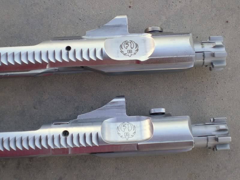

    I have an SR556 as well.
    The carrier is showing no wear, that is where Ruger or whoever they hired to make the carrier machined off some of the carrier rails in an attempt to reduce "carrier tilt". There are two different versions of the Ruger carrier, with slight differences in where they removed some of the rails.
    Pic #3 is cam pin drag, another artifact of putting a piston on an AR
    Pic #4 looks like a little wear on the buffer, no biggie.

    Ruger has decided that removing some of the contact between the bolt carrier and upper is one of the keys to stopping or reducing carrier tilt. I have a couple of their piston AR's and they also have the shortened carrier rails. The top one shows similar machine marks to the one you've got.
