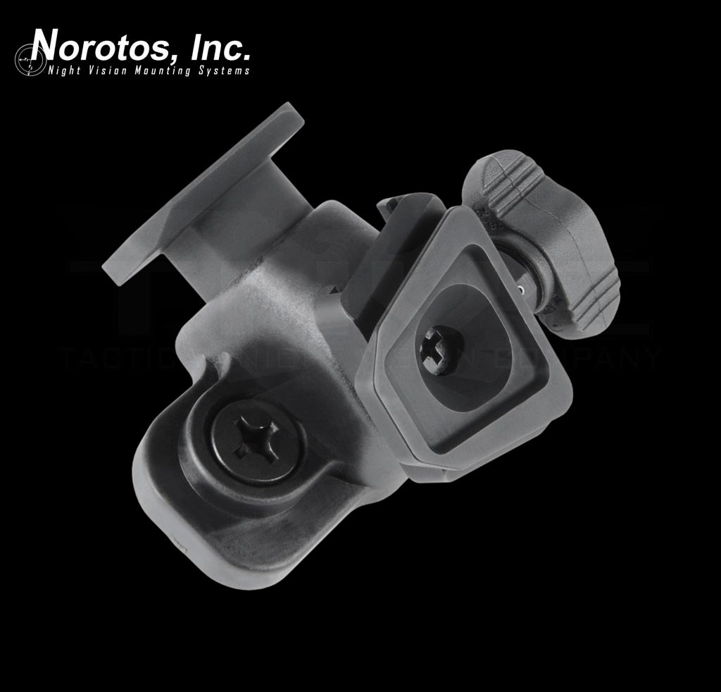

    Ok I got the new Norotos Adjustable Dual Dove Tail in today and basically what they have done is, put a small horizontally moving track under the dovetail mount. There is an easy to reach and turn, thumbscrew that locks down the side to side movement. I was expecting something that swung on a pivot like the J arm but this combined with the other axis of movement on the INVG provided all the adjustment needed to place the Monocular exactly where I wanted it. This new "adjustable" Dove Tail will retrofit to older Dual Dove Tails. I have not had a chance to ask Norotos yet but I Imagine they will sell just the new part.
    My only complaint now, about the whole set up is the fact that the DDTA places the On / Off switch of the PVS 14 (if run over the right eye) inboard, in front of your nose. If run over the left eye it places it outboard. In other words you have to use your left hand to manipulate the On Off switch. You can use your right but you have to reach either completely over the top of the mounted 14 or twist your hand around unnaturally to reach the switch. Now this is not a big deal and will require some getting used to but not a deal breaker. Again the stow feature of the INVG outweighs just about any negative of the system.
    All in all it gets an IPSC_GUY two thumbs up.

    Would you mind posting a picture of this?

    Here is a pic of the Version2 Dual Dovetail Mount from Norotos. It has been out since January (SHOT Show) and is the only model they are shipping. You can see there is an adjustment screw that tightens the rail slider for the positioning it over the eye, laterally. It is a pretty good solution considering what they have to work with. I have not experienced any sort of play in the mechanism.
