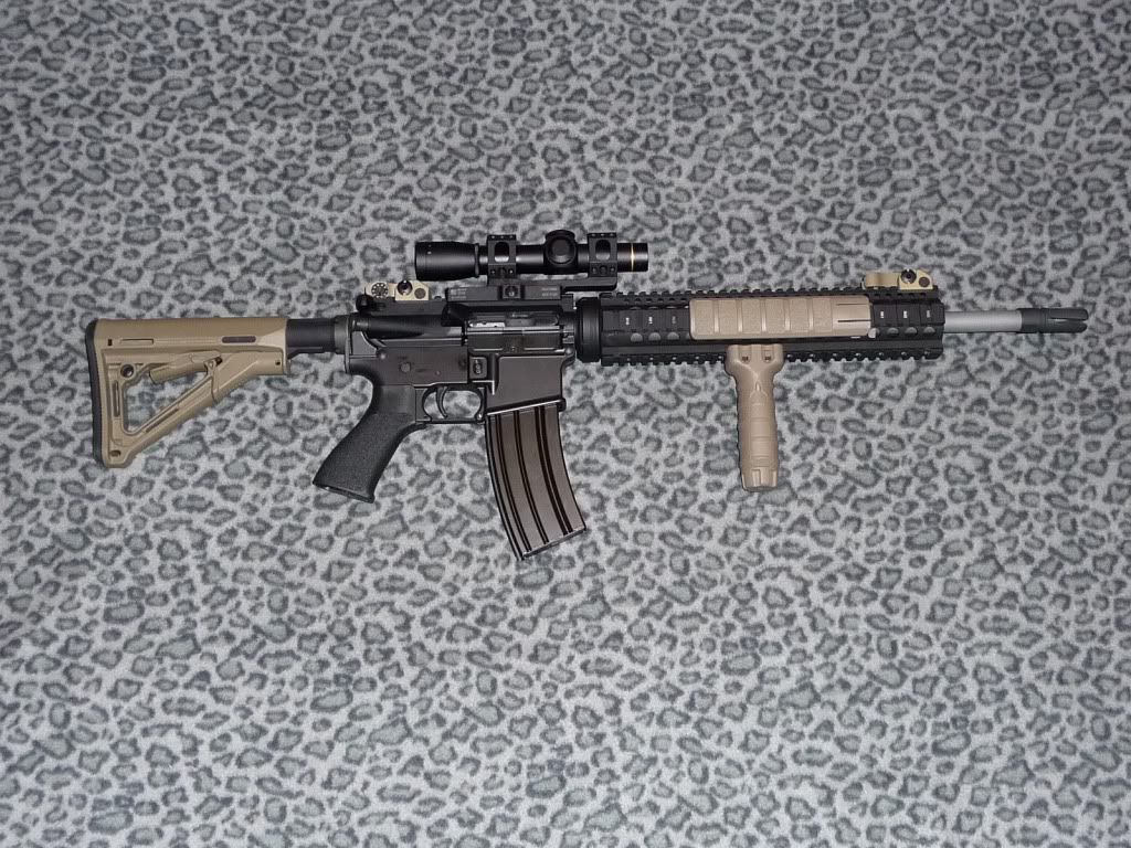

    Scout/ Long Eye Relief type Scope
    Quote Originally Posted by cemoulton View Post
    That's part of the reason I thought it must be a dumb idea. I can only find a couple variable power scopes with an eye relief that isn't way short or Just a bit to long. Bushnell make a 1.75-4 power shotgun scope that has 6" of eye relief. It could be perfect if it was illuminated, But I have a hard time thinking a $80 scope is gonna be worth a poop.
    I figured if someone would make them if it was a viable idea. I'm sure someone else has thought of this and ther is a reason these scopes aren't common.
    You have any thoughts?
    The majority of the 'Scout type Scopes' are typically of the fixed magnification model.
    Below is a Leupold Ultra-Light FX 2.5X20 mm. I more or less had the same idea as yourself. Although it is not a true Scout Scope, of all of the compact Leupold models I could locate it has (according to their specifications and product information) the longest eye relief of their compact line of scopes, except for the actual Scout Scope (listed at 9.3").
    The Leupold website lists the eye relief for this particular scope at 4.9". I can tell you that is very generous. I have used the Mark AR 1.5X4, Var- II 1-4X, and it is my opinion that the eye relief is greater with the FX 2.5X20mm model.
    The scope is also very fast on moving targets and lends itself well to shooting with both eyes open too.
    Not the same thing (platform), but I fired a Springfield M1A with a Scout Scope on it. It was nice, but not my cup of tea.
    Keep in mind that there are other Manufacturers who also produce similar scopes such a Burris, Weaver, and Nikon to name just a few.
    The only way you will know if it is for you is to buy one a give it a try. I really like the set-up myself. I will acknowledge that in the dark the scope does work with a light, but is not anywhere near an Aimpont or Eotech for effectiveness at close to medium ranges. The lack of illumination is definitely a disadvantage for low-light scenarios.
    On the other-hand, if you are simply looking for a general purpose sight to be used for off-hand shooting at a variety of targets like steel plates, varmints, etc. then this type of sight may be of use to you.
    I use mine for shooting steel plates, jack rabbits, coyotes, and other things. Just as an example, I do not have any trouble hitting 8-10" steel plates at 300 yards off-hand with this scope/ set-up.

    Thank you SkiDevil that ultralight might be just the ticket. Are you a nose to charging handle shooter?
  8. #18
    Apr 2009
    994
    No. I am not. I have my stocks pulled-back.
    I am 6' tall (plus) and have long arms.
  9. #19
