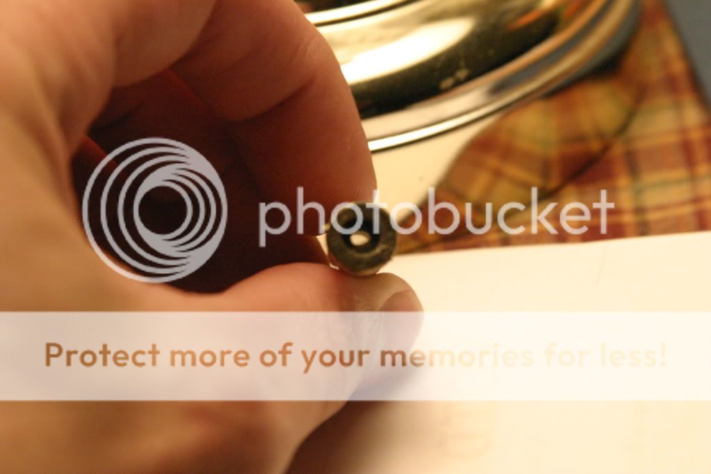

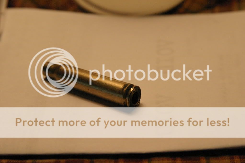

    I'm using reloads from Tactical Ammunition in Oregon. I've bought from them and never had a problem....but that would explain, but not all of the ammo was doing it....here are the pics of the brass in question. The loads are 55gr FMJ in Lake City Brass loaded to mil-spec standards. If its the ammo, it would suck because I bought 500 of them

    Unfortunately this is what happens when you buy reloaded ammo. Whether you had issues in the past or not is irrelevant.
    I would contact them and ask if they have a guarantee.
    I would also go buy some small amount of milspec ammo (which I believe is recommended by KAC) and see what happens. My guess is that it stops.

    The biggest problem with reloads is a lack of consistency. I wouldn't fire another round of that stuff. You might just lose your $2K investment if you do. I would try the rifle with some known factory 5.56 pressure ammo from a reliable source and then probably contact the reloader for a refund. My guess is that your problem will go away with true, in-spec ammo.
