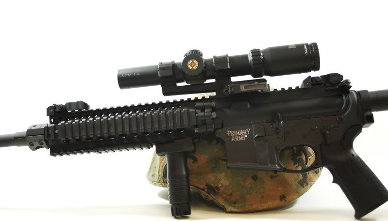

    The Scout will secure and rtz the same as the Recon....however for the small amt. extra, the 2 latched Recon is prob. a better choice so you will have a small insurance policy. I have numerous gear w. the ADM latches and never had one fail so take the insurance policy for what its worth.
    Personally I never get a non-x version because the x will never be a detriment yet the non x could be one if you need more eye relief while still using the actual upper receiver to mount it on. So I would get the Recon or Scout X but any way go you will be gtg.
    mounted on guns....
    [IMG][/IMG]

    +1 on the extended. I run a extended Bobro with my XTR so I can shoot NTCH. ADM extended would do the same. Non extended will not unless you run it forward of the upper receiver rail or have a monolithic upper.
