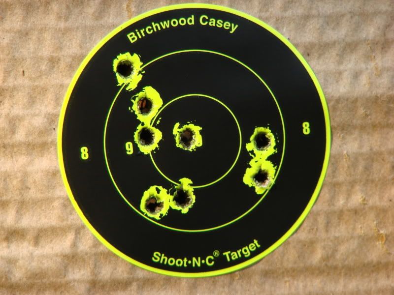

    Here is my initial 50yrd zero group.

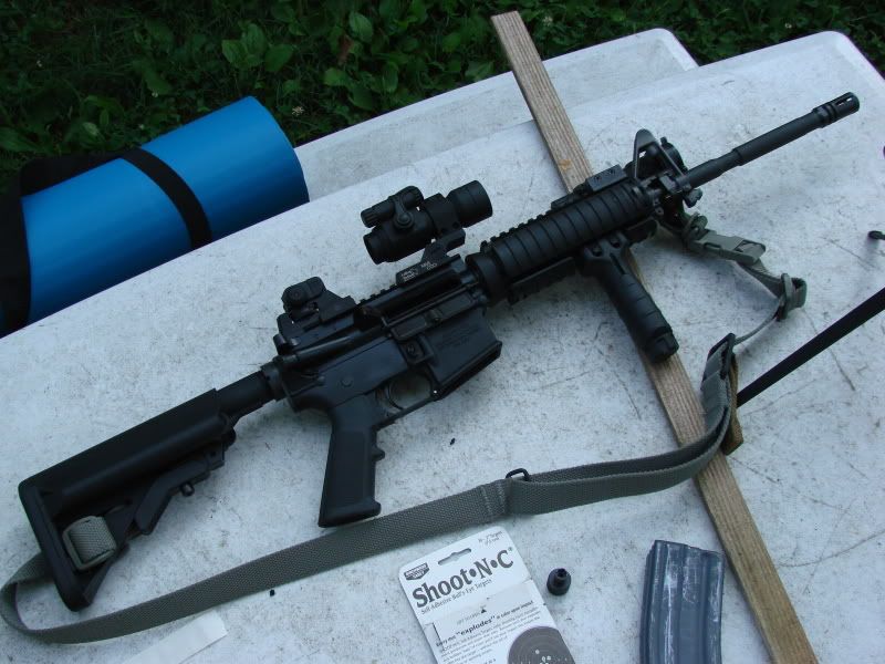

    and here is my set up. Ammo was Win. Q3131A. I've always zeroed at 50 at home and shoot at 200 when I get to the range to check/confirm at 200. The environment here in east TN doesn't present many 200+ yrd shots so I've always concentrated at 50 but my groups at 200 have always been good enough to take, say, a coyote at 200 which I've always been satisified with. I stock 55gr ammo for price considerations, most of which is Prvi M193. My carbine is much more accurate with Prvi 75gr match but I have very little of it so I don't zero with it. On the last range trip I shot at 100 just to get the feel of the new Larue mount and was a little puzzled with how high my group was. Due to the extreme heat this summer I didn't concentrate much on my goups, in fact after less than two mags I was content to set back and drink water to replace the fluids I was losing. As the weather is now begining to ease a little I'm kicking around the idea of trying a 100yrd zero.

    I set my rifle at a hard 50 yard zero, the 200 yard zero falls closer to 230. Ammo was plain old PMC 55 gr. FMJ, rifle set up with 2 moa Aimpoint, 16 " midlength.
    I understand your question about group size at 200. If your group at 200 is say 6-7" how can you verify the zero? Is that your point?
