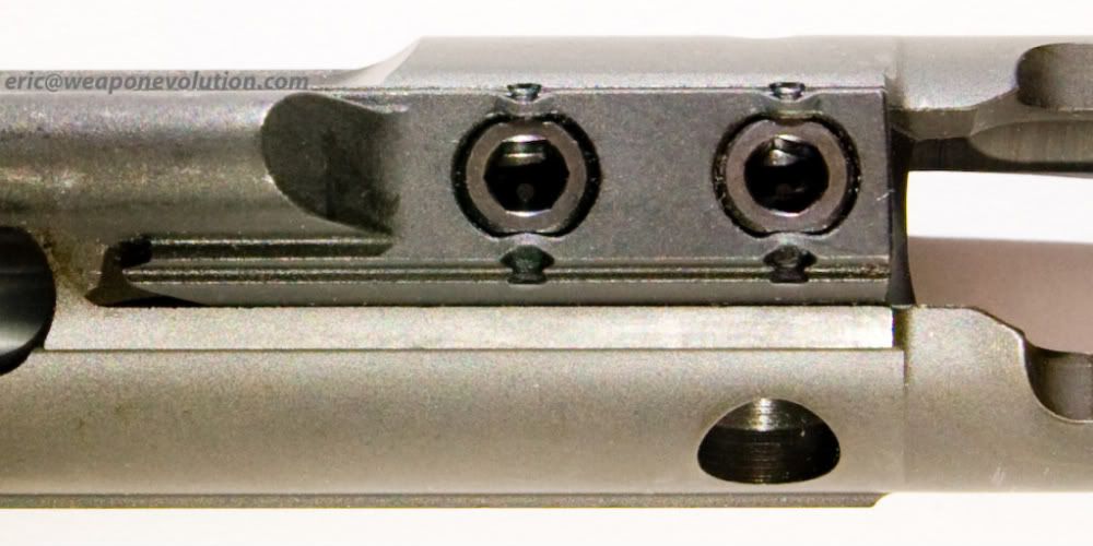

    Can some one show me a pic of proper gas key stacking?
    Staking isn't rocket science, but it is amazing how often it's done poorly. There should be enough material displaced from the gas key so that contact is make with the screws. This simply prevents the screws from backing out. At the same time, the staking does not need to be applied with a 10 lb sledge.

    Here is a pic of my gas key. Good or not?
  8. #18
    Jan 2007
    3,562
    I'm far from an expert, but it doesn't look like any metal was displaced into the screws themselves.

    I will try and get a better picture.

    Is this any better?
