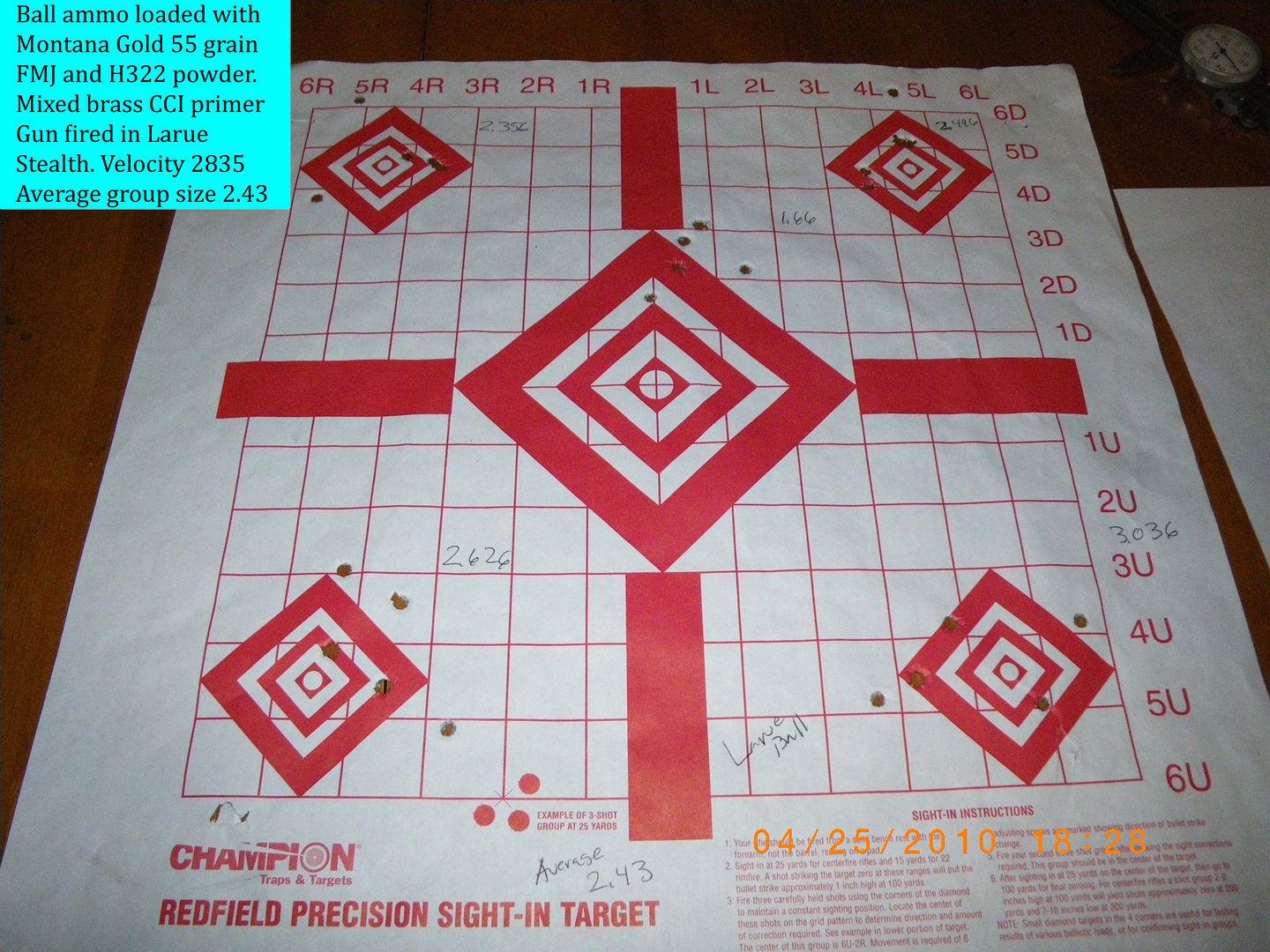

    Quote Originally Posted by NavArch View Post
    OK. I've got it that my 1:9 upper needs to be replaced by a 1:7 upper or be re-barreled if I want to move from 55 grain bullets to 75/77 grain bullets.
    Here's the question: Once I do that, how accurate will I be shooting 55 grain bullets in the 1:7 barrel at 200-300 yds? I have what I will call "an adequate supply" of 55 gr ammo, and am not going to be able to completely swap it out really easily. Do I need two complete uppers in order to make the best use of my ammo supply?
    Thanks.
    My 1/7 twist Noveske shoots 52 to 55 grain ammo just fine. It also shoots 77 grain loads great too.
    In fact my 1/7 twist Noveske shoots ball better than my 1/8 twist Larue. It also shoots better than the Laure with 52 grain match bullets. The Larue however kicks its but with 77 and 75 grain bullets.
