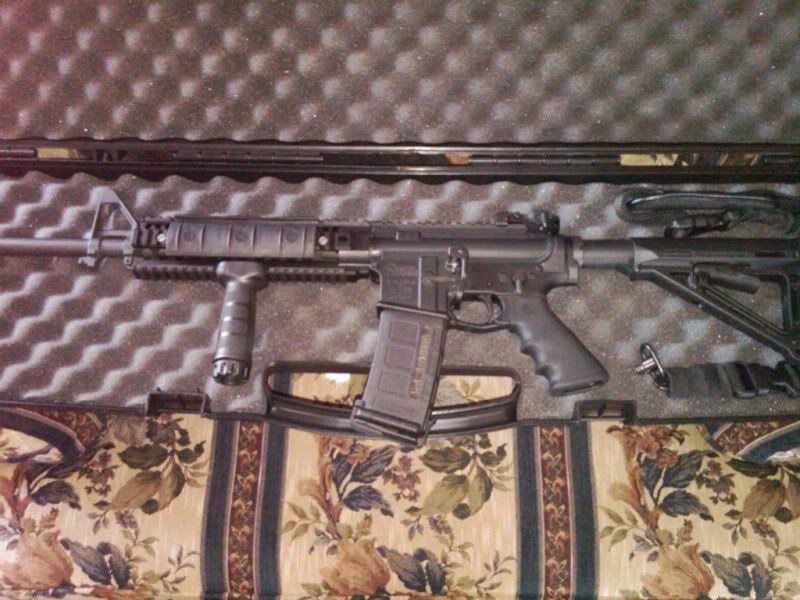

    Mags
    Did the XV not come with a PMAG?
    [IMG][/IMG]

    Quote Originally Posted by xbmxracerx View Post
    Not always.. my gunshop gave me a EMAG and no instructions (Which aren't really neccessary of course if you already know the basics of the AR platform) with my DD because they misplaced the original carrying case and pmag.
