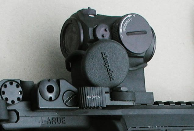

    risers
    LaRue:
    GG&G:
    Wow, the GG&G riser is rather inspired - the LT a bit less so...
