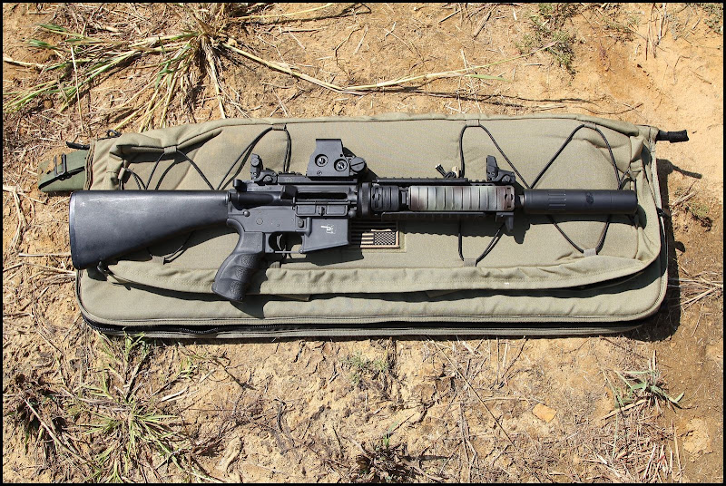

    I shot my Noveske 10.5 Yesterday on an M16A1 FA lower.
    I ran it with and without the AAC M42000 and it functioned flawlessly.
    There's just something about this Noveske upper that makes me prefer it over my Colt 6933 - 11.5".
    I have the AAC Brakeout and an Eotech XPS on the Noveske.
    ___I forgot to give a shout out to Rob @ Virginia Arms in earlier threads for putting the Brakeout on for me.
    VA had quick service and great installation and shipping costs -end Virigna Arms plug______but seriously, I would use them again
    I know that the Brakeout makes muzzle rise practically nonexistent and fat chicks love the fireball coming out the business end.
    I would by another Noveske SBR upper in a second.
    The switch block is interesting, but I've just never had a problem with any of my guns running suppressed so I hate to spend the extra $$ on a solution to a problem Ihave not had on my guns.
    Having said that, If I came across a good deal on a used Noveske with the switchblock, I wouldn't turn it down.
