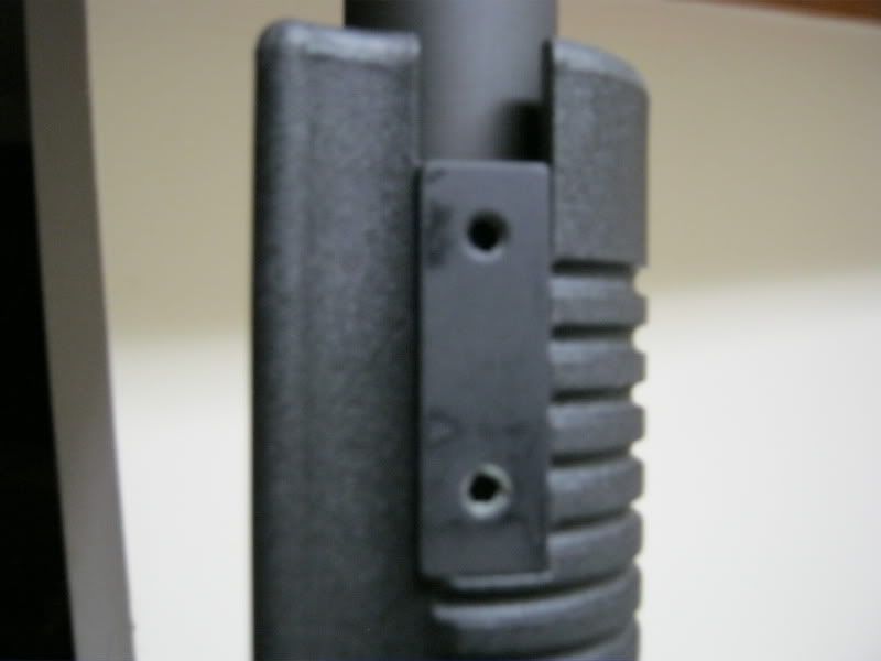

    This is the flashlight mount I have on my 870P and I really like it.
    It is solid and doesn't add a lot of bulk and weight to the front end.
    They just cut out a piece of the forend to make room for thier mount which mounts to the magazine tube. The part you can't see it a ring on the back side of that rail that goes around the magazine tube.
    Anyone else use this?
    Here's a pic of it on my shotgun.

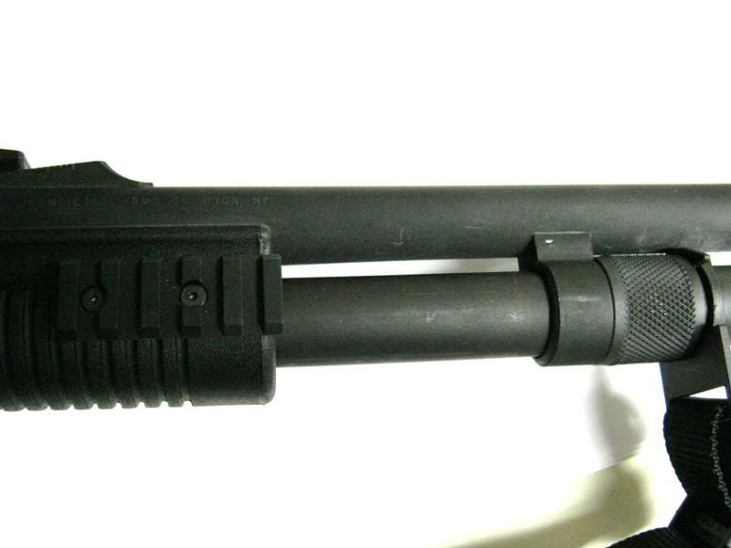

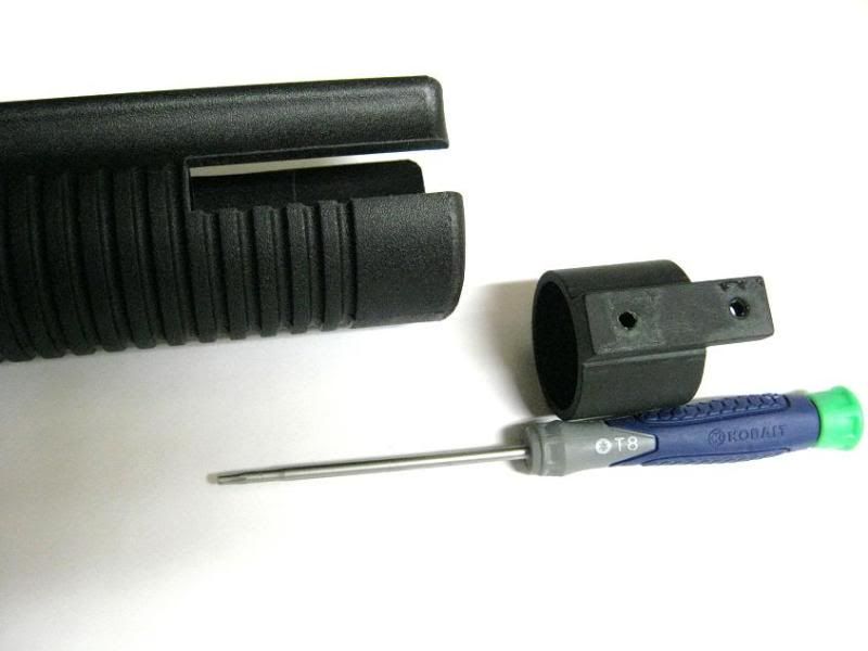

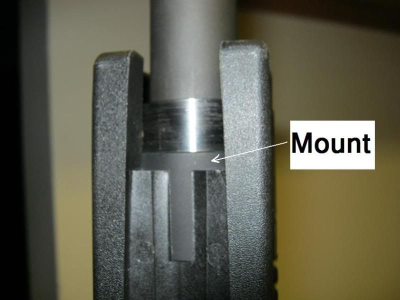

    Quote Originally Posted by Bsully View Post
    How many full threads you have left holding that cap on?
    Does it go on enough to lock into the spring cover?
    Not sure what cap or spring cover you are talking about.
    But I have a Wilson Combat one round extension on the shotgun.
    The pictures below show the mount slides over the magazine inside the modified GG&G forearm which comes with the mount. You need a special wrench to get that castle nut off, but it tightens up just fine. Other than that the mount doesn't have any affect on the magazine cap.

    Quote Originally Posted by CC4me View Post
    Gotcha
    and thanks for the pic's,
    I was thinking it went over the mag tube and was held on by the magazine cap
    but after viewing the pic's I can see how it's mounted on the forend tube and held on by the tube nut
    btw the spring cap I was referring to is the mag spring retainer which would be mute when using the ext
    Definitely going to look into picking one up after seeing it tho
