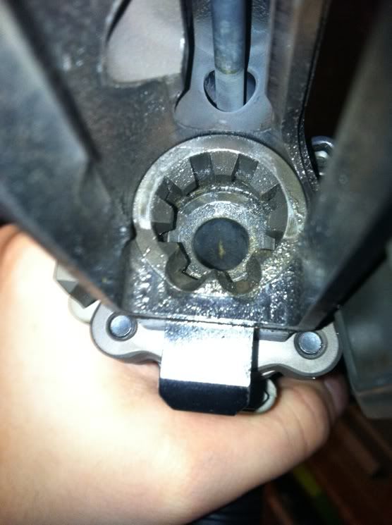

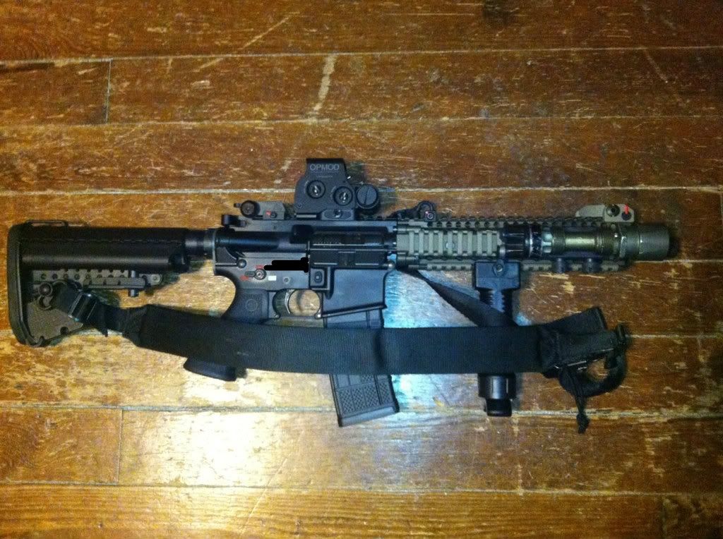

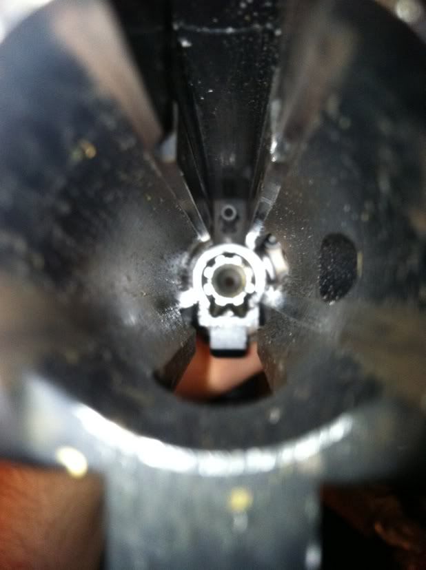

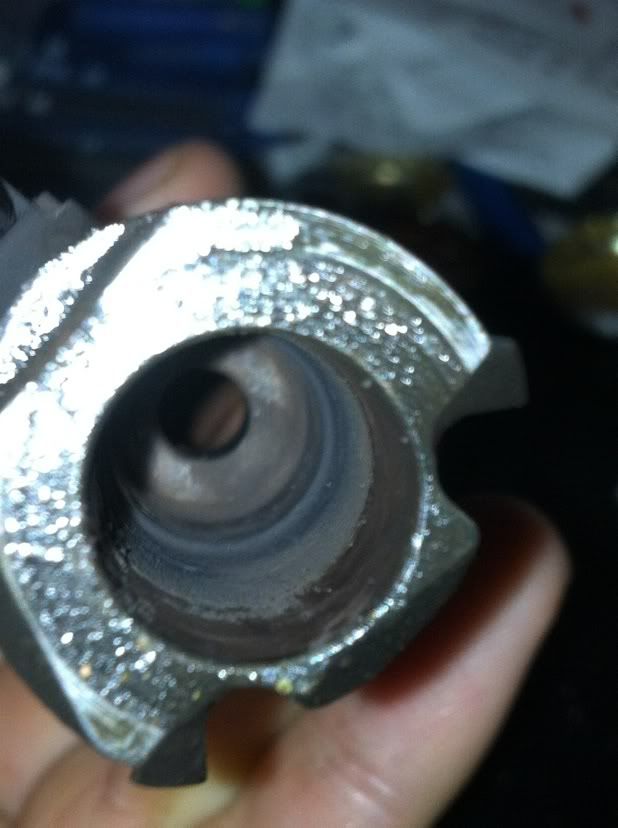

    Something I havent done is a range report on my DD MK18, This pic was taken around the 4,000 round mark and here I had a session where I put 800 rounds of 55gr Wolf ammo through it in just over an hour. I lubed the BCG up before shooting with 5w-30 synthetic motor oil. I had 3 FTE's from bent case rims which is completely ammo related, but they did require a rod to remove. I eventually broke the bolt around the 6-7,000 mark but this gun was over gassed as well.
    I put 3 drops of oil on each rail, 4 in the cam pin slot, and 2 drops in the exhaust vents to get it on the gas rings.
    Gas port was .083", from what I am told they are now making them with a .075" which will be even better. Anyways some after action pics.
    Overall the gun ran great and was way to hot to hold at the end even with gloves, I was rocking a mag well grip near the end. But MY GOD was the Wolf ammo dirty, and I could tell the extra blowback you get from it not oburating properly.

    Another thing to note about my post is how dirty the rifle is, its the only thing I hate about the DI system. Took me like 20 minutes to get that rifle clean after that outing.

    Your bolt is like that because you're not lubing the weapon enough. Not sure why you chose to lube it with a few drops here and there, but you really need to lube it.
    I find the bolt breakage interesting. My BCM bolt has over 11K rounds on it and all I have replaced is the ejector spring. I run this thing suppressed about 60% of the time and use M855, M193, PMC Bronze, PPU M193 and SS109, and Hornady Steel TAP.
    It was still a PITA to clean lol, I hate cleaning guns and that was one nasty gun for not using a suppressor.
    I only did a few drops to test how it ran with minimal lubrication, it did well and since my life was not dependent on it running it didn't matter, I figured the early bolt breakage was due to the .083 gas port. From what I am told 7-8K is also about average for a bolt in the MK18.
