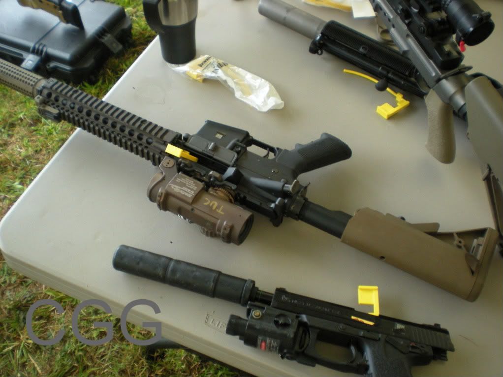

    Here are most of the pics that show the rifle well that I have saved from the internet. At least two of them are Colt receivers and they appear to have Mk12 gas blocks.
    From Daniel Defense IIRC:
