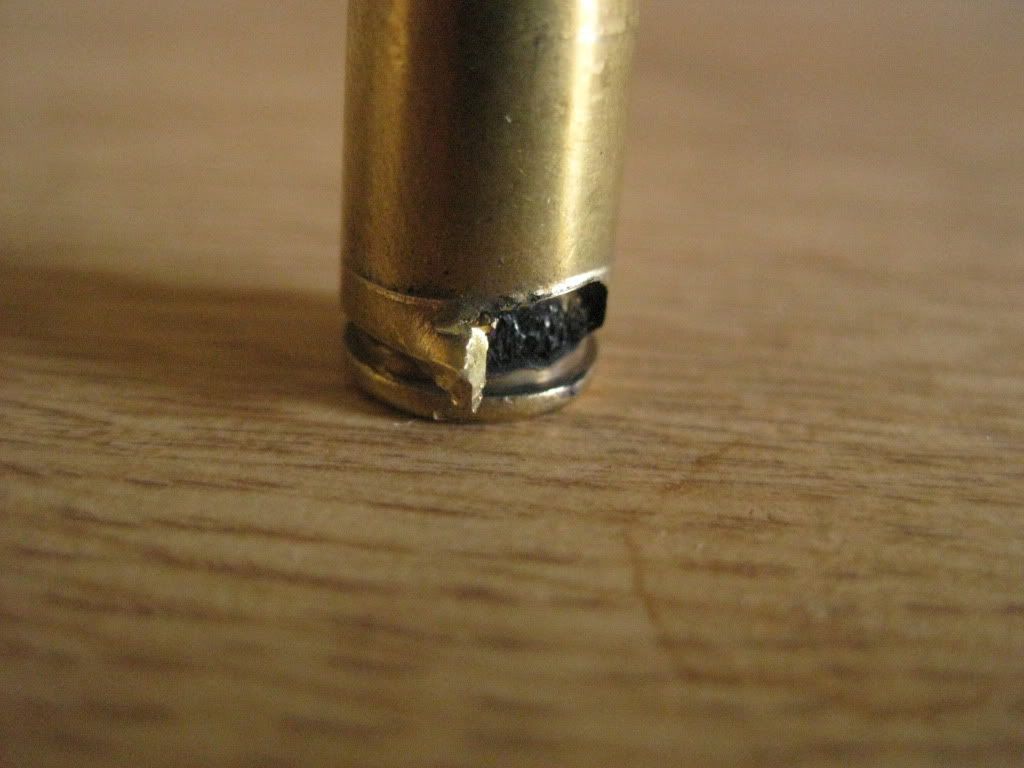

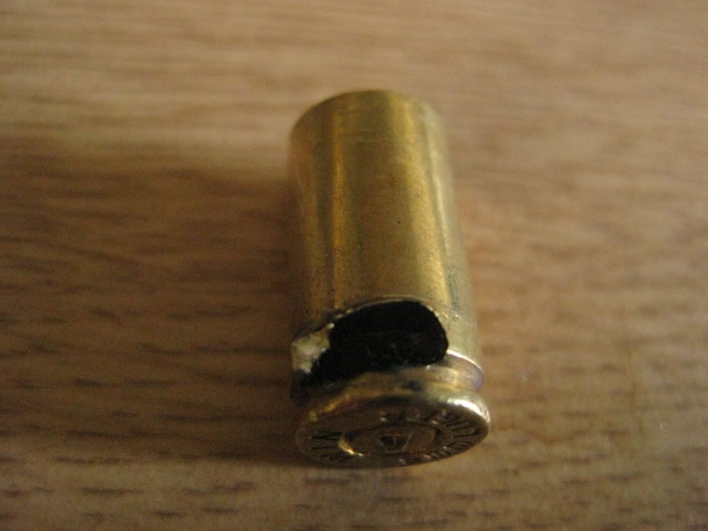

    I went to Bass Pro to shoot my new OD G19 I ordered from Eds last week. Haven't fired a single round thru it. Grabbed a box of Ultramax 115gr 9mm rounds and figured I'd buy some WWB when I got up there.
    Everything was fine and dandy for the first 13 shots. Hit the 14th and it felt like somebody hit me in both hands with a baseball bat. Just intense stinging. Upon firing that round it made a puff of smoke around the gun and it shot the magazine about 4 ft in front of me. Truth be told, when it happened, I couldn't believe it. I DIDNT WANT TO believe it. I walked out and told the RO what happened. We examined the 19, found the casing (that was laying right underneath me) and checked out the magazine. I took it all apart and absolutely nothing was wrong with my 19 or the magazine. The problem case on the other hand, had a hole about 1/4 inch long at the BASE of the case. I don't know if its from a weak case or if it just exploded. I'm not too familiar with this.
    What should my next steps be? I did load up some different rounds after inspection to see if my gun still functions as its my carry piece and needed to know. It shot fine, looks fine. Just a hurt hand and ego.

    Looks like mistreated brass. Not on your part, most likely manufacturing error. metal shrinks and expands all the time. Also might be overload.

    Weird looking brass.....as if its belted?

    Don't know much about the glock design but the case sort of looks like it was fired out of battery. Surely it can't fire OOB...

    Send it to Glock, with the magazine that was ejected, and pictures of the ruptured case.

    Have you got a better pic of the primer?
    +1
    If it fired out of battery, could you tell this by the strike on the primer being higher than usual?
