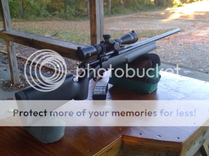

    Yes, it will work. I have the same stock on my 12FVSS, which is the same newer centerfeed 4.40" style. I really like the stock...it's solid, looks good, and at a fair price. I've shot mine out to 1000 yards with no problems...and it's a .223.
    I got the stock here, but looks to be the same price as Stocky Stocks...http://www.shootersdiscount.com/cart...ewCat&catId=49
    And here's some pics...

    That is very nice

    Thanks man. You'll like the stock...good luck with it!
