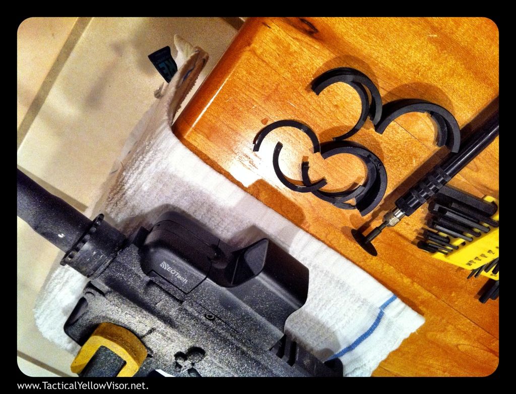

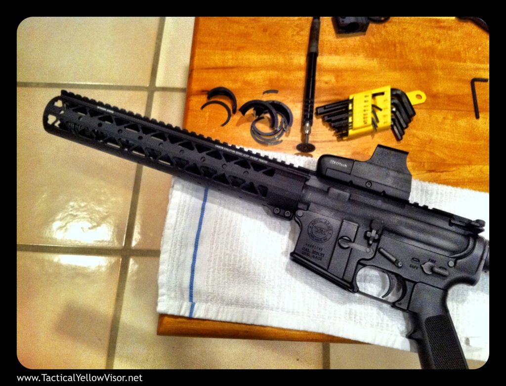

    I installed a Rainier Arms variant of the Samson last night. I chose to install it on my 9mm SBR and chose to use minimal tools rather than break out the entire tool bag, to see if it really was drop-in and to see things from the perspective of a typical buyer.
    The plan is to shoot this today at the local steel match, which was the reason I bought this SBR several years ago and never got around to actually, you know, shooting it.
    Before

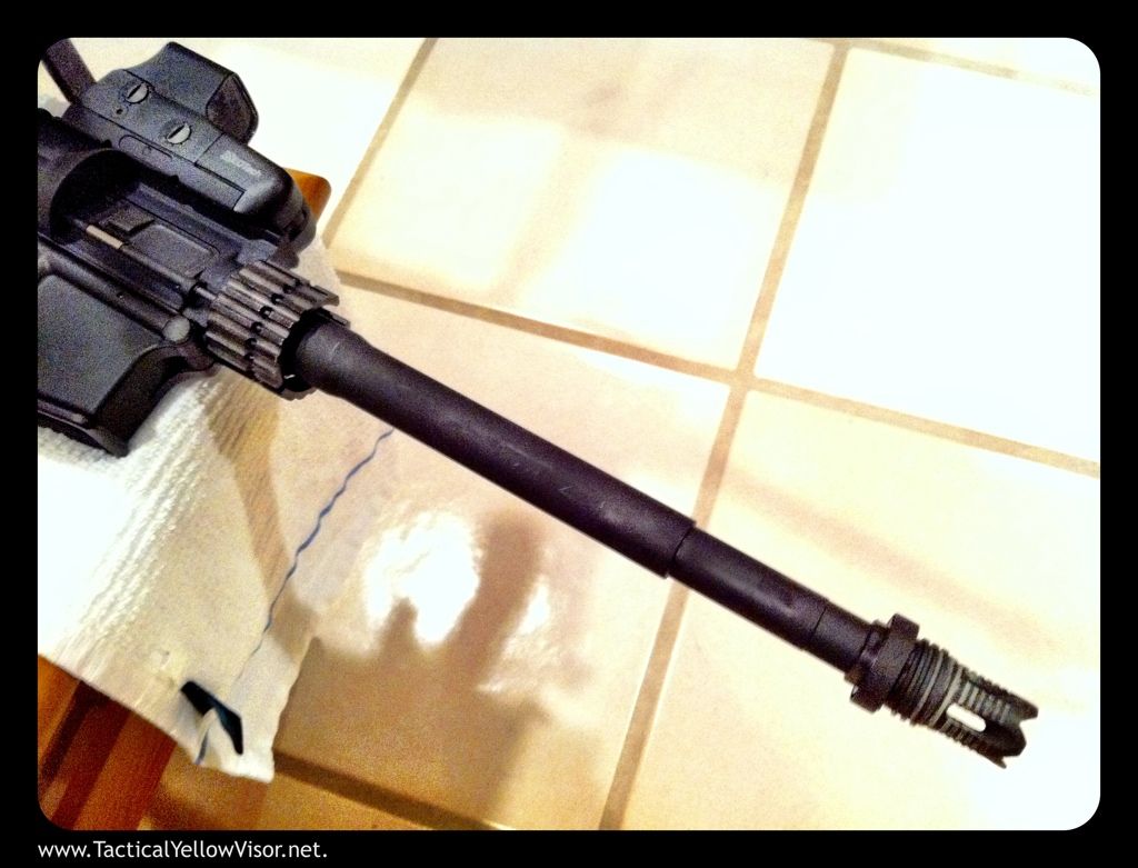

    during (stock parts removed)
    during (sacrificial parts cut away with Dremel)
    during (suppressor mount reinstalled with heat-sink mounting collars at barrel nut)

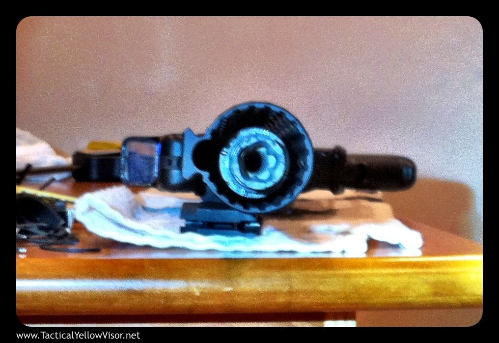

    during (you need to check alignment as you tighten the mounting screws)
    during (tube mounted, no can)

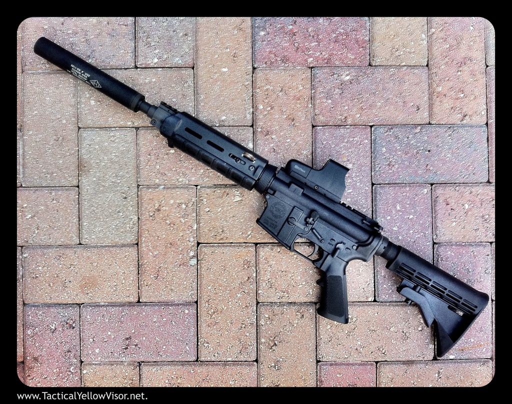

    After (tube and can both mounted, ready to shoot)

    I was very skeptical of this tube. I would NEVER have bought one on my own, as I was happy with the Troy of similar design. I would have missed out. While I can't speak for the Samson design, I can only assume that it would be at least similar.
    I shot two matches today. The first was a steel match where most people shoot pistol but where you are also allowed to run pistol-caliber carbines. I chose to run this carbine. It's very simple, 5 stages ~5 rounds each, shot 5 times each. That's about 125 rounds. Then I stayed on for another match, this one a carbine steel match, where I used the same gun, and fired around another 100 rounds.
    This tube has an OD of 1.80" compared to the Troy at 1.74". I would not have thought that the 0.06" would have been even perceptible but it is, and I prefer the larger tube OD. However, for comparison, I find the 1.90" OD of the JP tube to be too large. With the larger OD comes a larger ID of 1.56" so even a 1.50" OD centerfire rifle-caliber can should fit inside. In my case I'm using a 1.25" OD 9mm can with plenty of room.
    I'm looking forward to running this gun in this setup at the same match(es) next month. I may look into shortening the barrel, and I'm definitely going to see about adding a hand-stop at the booger-picker location I prefer for such things.
