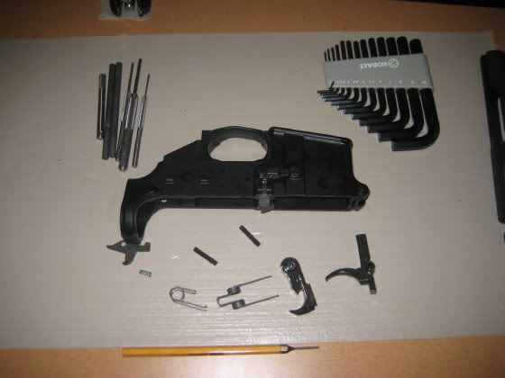

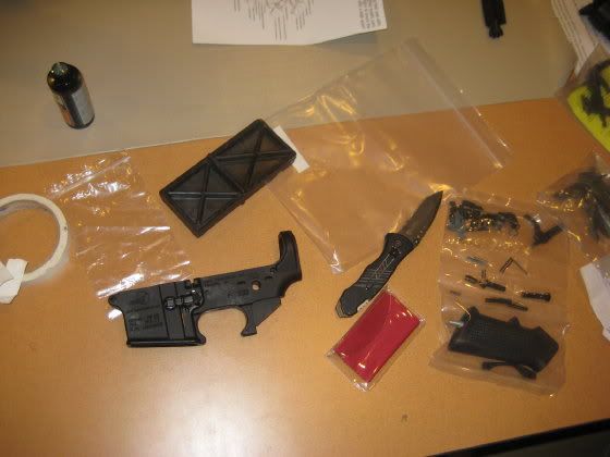

    The lower was bought from Shoot Straight for around $100 bucks which I know is a tad high but I dont have an FFL so after transfer fees would be in the same boat without the ability to inspect before buying so it was worth it to buy it locally for me. It is made by Areo Precision which I was pretty skeptical about as Ive never heard of them before. After a little research I found a lot of recommendations for them so I gave it a shot. The lower was flawless and everything fit easily when installing the LPK. The fit between the lower and upper receiver is perfect with no wobble or play.
    I started out installing the norgon ambi mag catch so I could use the mag block in the vise while installing everything else.
    After that I taped up the receiver and installed the magpul trigger guard which came with the DD LPK, bolt catch, trigger and hammer assembly,
    RRA ambi safety selector, and hogue grip. Everything went together perfectly and performed all the function checks as per the video recommendations such as Mag release, bolt catch, Trigger operation, tested for fire on reset (as I had a lower start doing that and it was dangerous) and fire safety selector operation. Never let the hammer fall on a dry fire with the lower separate from the complete upper. I guess its bad. I watched a youtube dude do it like 50 times to show his assembled lower was working great.

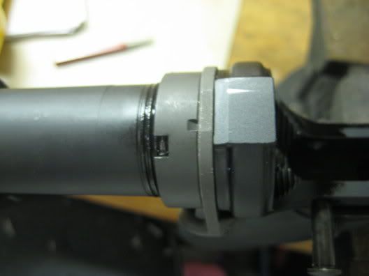

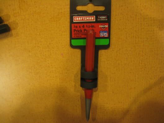

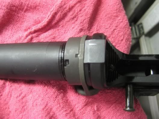

    I received my castle nut as promised by Larry so I figured while I was waiting for my CTR stock and junk to show up I would go ahead and swap out the PRS stock and buffer tube for the commercial collapsable buffer tube and H buffer. Ive never staked a castle nut before so I took a few pictures just incase anyone was curious of how it was done. I first did some research on this site believe it or not and went out and bought a prick punch from Sears
    The hardest thing I found was trying to get the little magpul ASP plate mil spec key into the slot on the tube. I learned most of my small tools have become magnetized to some extent causing the little bastard to keep moving out of place. After dicking with this for about 10 minutes it finally fell into the slot and I locked the castle nut down.
    I went out to my garage and put the lower in a vise and tried to support it by the base of the buffer tube as not to break anything when I smacked it with the hammer and punch
    Before:
    After:
    Not much to look at but it'll do

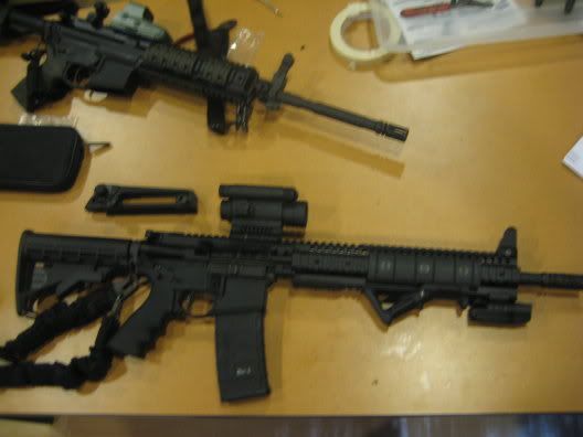

    Then just for shits and giggles I went ahead and put my Stag collapsable stock on it till my CTR arrives along with the M4 optic and some rubber rail covers. I have also ordered some XTM panels to cover both sides with and will use the ladders for what ever is left on the top and bottom.
    Still have not made it to the range yet!!!!! It's driving me nuts. The kids are out of school this week so no range time for me. Gonna try and squeeze out tonight when the girl gets home just to see if the freakin thing even works
    On a side note, The heavy ass PRS stock did balance out the rifle really well and I wonder if it wouldn't be a bad idea to run it with it on. When I went to the standard one it did feel more front heavy as expected.
