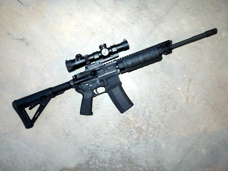

    I've read the same article by Eric Poole and recently received a SIG516 for T&E. I have only put 80 rounds through my sample, which isn't even enough to burn all the packing oil out of the gun.
    Out of the box, the trigger on my sample is quite good. Maybe a little on the heavy side but it is crisp as a new potato chip. The safety moves freely, crisply and smoothly.
    There are some visible tool marks on the bolt carrier and a couple sharp edges. The gun ships with a shrouded but semi-auto carrier. I don't have one to compare it to but I'd swear the Sig's bolt carrier is identical to that used in the LWRC. Interestingly the bolt is a conventional AR bolt to include the gas rings.
    Accuracy seems on par with most "stock" AR's in that it'll put three rounds into about two or two and a half inches at 100 yards. The recoil impulse is sort of a quick slap and is harder than a DI gun and harder than some piston guns. Not that it's bad or unmanageable. It's just different. Some of this might be based on the rifle's balance point. As another poster mentioned; the gun isn't nose heavy like some piston guns can be.
    The gas system is easy to switch from "regular" to "adverse" but it's a bit more labor to disassemble than some other designs. The piston rod and return spring is an assembled and captured unit with a small roll pin holding the entire assembly together. I wonder how long the little roll pin will last but I guess it won't really do anything if it breaks other than make the gas piston rod harder to put back in the gun.
    I haven't confirmed this but it looks to me like the barrel uses a standard barrel nut and it looks like the pin hole spacing on the gas block is the same as that of a standard AR-15 front sight base. If that's indeed the case, it'll certainly simplify future barrel replacement. With that said, I do not really care for the carbine length forend and wish Sig would have used some type of intermediate length.
    The ambi mag release is kind of nifty but really is not necessary. And I'm not big on the Chinese red dot that came with the gun. I guess it works but I would have rather seen a decent set of iron sights rather than an offshore Aimpoint clone.
    If I can convince Sig to send me an F/A bolt carrier I'll see how the gun runs on a select fire lower.

    Sig's gas parts and full-auto carrier.
