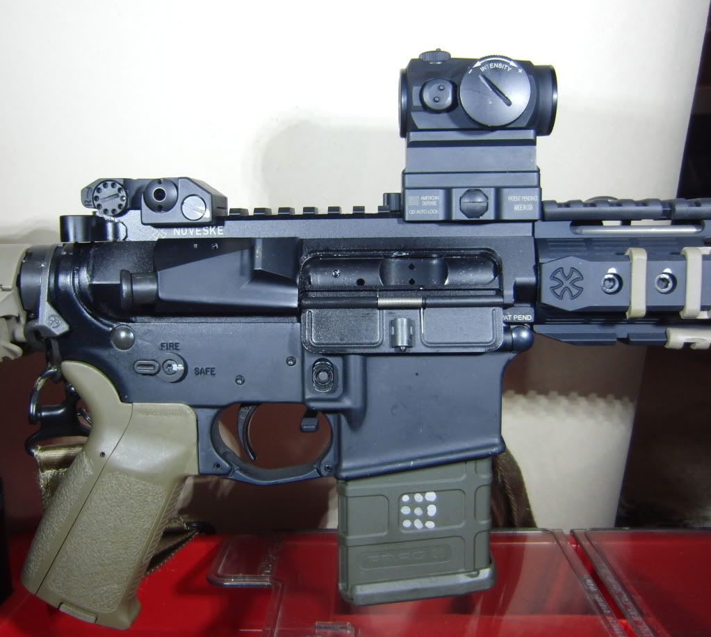

    Also, here is a minimally compressed (18) JPG taken with the same lighting just to show the macro capability of the camera.
    http://i923.photobucket.com/albums/a...ples/Nov16.jpg
