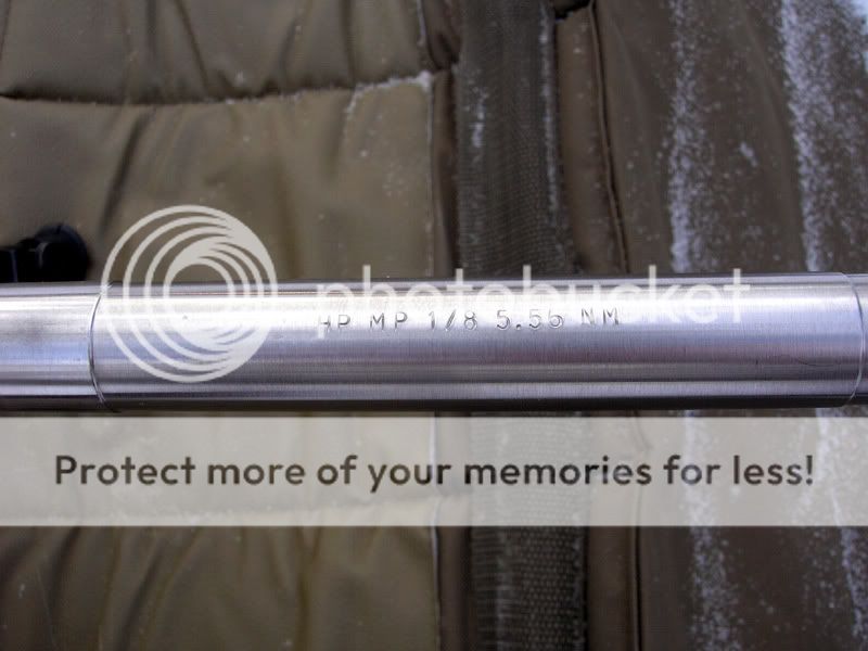

    The barrel is 410 stainless steel. The barrel blanks come from a top notch barrel company, and are likewise cut at a top notch shop. I purchased the "service match heavy weight profile" barrel, which retails for $299 in the standard SS finish. It's is a semi-shiny silver finish, which looks really sharp with a black gun. I was thinking about painting this puppy, but as all of my rifles are scratched up work guns, I figured this one will be my "bling" rifle.
    For a few dollars more, it is available fluted, ion bonded black, or a combination. I did have a chance to compare the fluted barrel and the heavy weight side by side. The fluting probably shaved a little shy of a pound? There was a noticeable weight difference when you hold them side by side, but whether you would notice once its on your gun or not, I can't say.
    The barrel has a rifle length gas system. The bottom of the barrel came with one dimple drilled to mount a gas block set screw. I ended up mounting a YHM low-profile gas block, which has two set screws. I decided not to drill a second dimple, and the gas block fit snugly without any problems.
    The barrel is button & hand lapped rifled with a 1/8" twist rate which should be sufficient to stabilize your heaviest 75-77 grain rounds, but still shoot 55gn rounds well too. They barrels are high pressure tested and MPI inspected.
    The chamber is cut to the USMC SAM-R Chamber specs, which is similar to a .223 Wylde chamber. Paul said his #1 goal with all of his products is to make it reliable, and to mil-spec. With this chamber you can shoot military 5.56 ammo, but it should be slightly more accurate with .223 match ammo than a standard 5.56 NATO chamber.

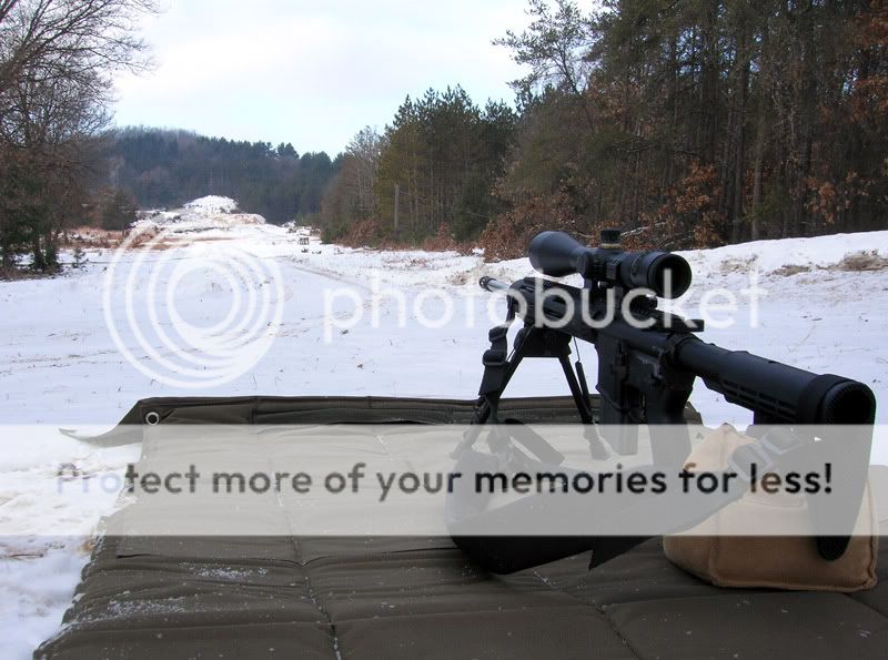

    Total weight of the rifle unloaded is 10 lbs 15 ounces, which certainly isn't light, but its not terrible I guess. My primary purpose for the rifle is for blasting prairie dogs and plinking steel out to 500m+, I don't plan on trekking miles and miles toting this thing around.
    Here is our steel range. There are indeed targets up on that hill. I forgot if its 500m or 600m. The highpower range goes out to 1400y for what its worth, and guys with their .338 Lapuas make head shots at that distance....

    As I said, this wasn't a very scientific test. I shot everything off the bipod, with a sandbag under the stock. The temp was 12 degrees with a little breeze. My receiver starting icing up from my breath, and my fingers got pretty damn cold by the end of each group.
    I shot these groups quickly, just taking breath or two between shots. I also have limited talent. I have no doubt that with match ammo, under ideal conditions, with a more talented shooter than me, this barrel/gun combo would shoot 1/2 MOA or better.

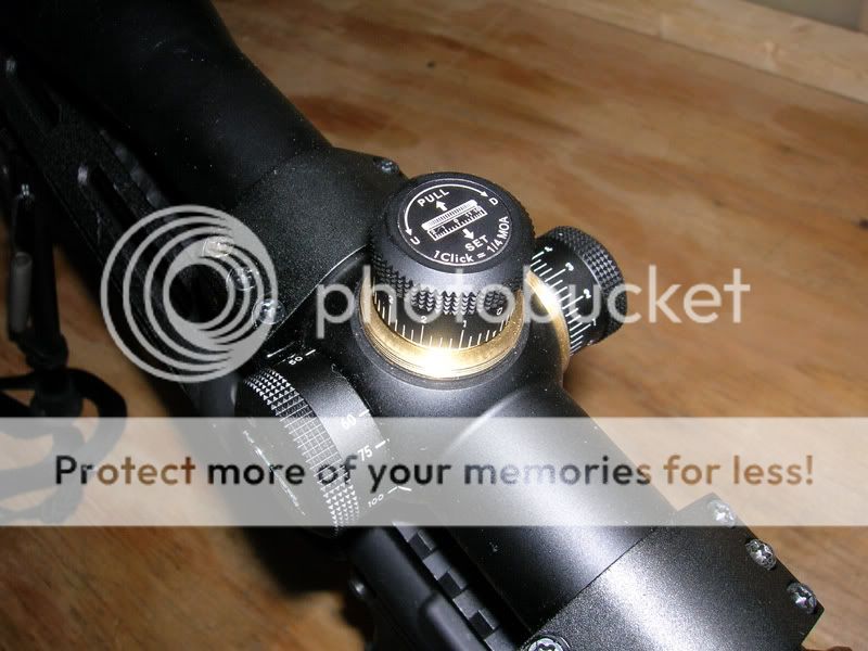

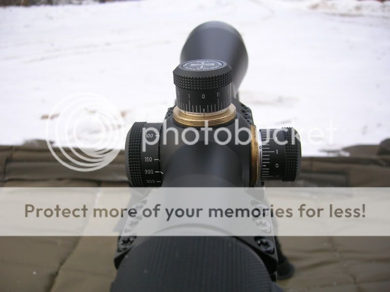

    Vortex Viper 6.5-20 x 50mm Mildot
    Vortex, being a local company in my area, treats the LE guys around here great, and they're customer service is top notch. Being a recreational gun, I wasn't looking to drop a ton of cash on glss, but wanted something with mildots and target knobs. It's probably a bigger scope than would be needed on an SPR type gun, but for shooting 8" critters at 300 yards, the extra magnification is nice.
    The knobs have a quick zero feature - you pull the knob up and twist to re-zero so you don't have to loosen screws and crap. Side focus parallax, 30mm tube, and the image is bright and crisp. It's even looked good when I've played with it at night. As expected, no problems with fog, going in and out of my warm truck today. I was dinging 18" plates out to 500m, and when I dialed the knobs back to 100y again, it was dead on. I was going to do a box test or something, but it was too damn cold and I wanted to go home.
    The magnification adjustment turns smoothly even in cold weather. To correctly use the mildots, the scope must be set on 14 power, which I thought was nicer than 10 power when I was trying to hold over on small steel plates at 500m. Unfortunately, Vortex only offers illuminated reticles in their lower, Crossfire line. Not all reticles are available in all their optic lines. Viper is the highest end scope you can get a mil-dot reticle. Their new Viper PST (precision shooting tactical) is available in MOA/MRADS (no illumination). Likewise with their Razar line.
    If this was going to be a working gun, I probably would have opted for a higher end scope. Not saying there is anything wrong with the Viper, I would just use something that has a proven mil/LE record, because that's how I roll (I don't fully trust my EOTech). With time, Vortex might be competitive in that market. I can tell you the guys there are great, their customer service is awesome, and they're products are an incredible value. Really, unless you plan on jumping out of a plane or capping hadjis at 600m, I think a Viper line scope is plenty sufficient for your zombie / prairie dog / etc hunting you might be doing. Use the money you save on training or ammo. The optic rings now are Vortex as well, and they seem pretty solid, but I plan on picking up a LaRue SPR mount just because I have never been disappointed with anything from LaRue.
