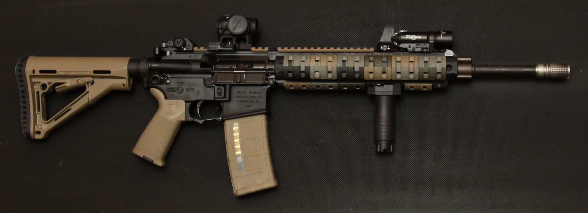

    It's work great with either rifle. I'd recommend the 5oz buffer and a standard rate A2 rifle spring. My KAC SR15E3 now has the A5 system and with the 5oz buffer and the KAC Triple Tap. Actually shoots softer than my dedicated 3gun rifle which has the same A5 buffer system and a Surefire brake. The KAC has a tiny bit more muzzle lift but the actual push to the shoulder is softer!
    My KAC SR15E3
    My 3gun rifle, 16" BCM chrome-lined midlength, Lancer lower
