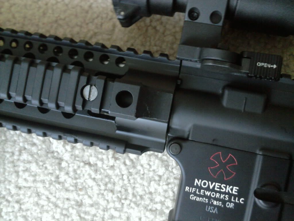

    Interesting....what is that tab on the rear of the rail where it joins the receiver?

    Quote Originally Posted by Singlestack Wonder View Post
    Yeah, what is that? I went and checked my OmegaX and it didn't have a tab sticking out on the receiver side...

    Quote Originally Posted by dcs12345 View Post
    New anti-rotation tab for the Omega series?
