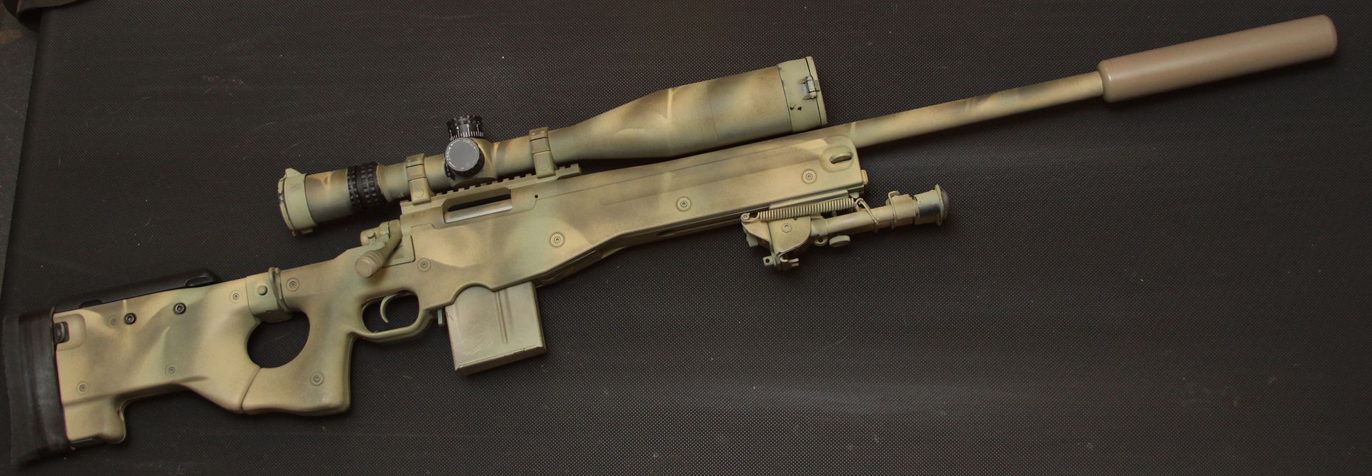

    Good to know that you guys recommend this Kevin. I got into a discussion about 3-4 weeks ago about liking a direct thread on Cyclone. Some self appointed expert said that this will cause barrel threading wear and I'll lose accuracy.........
    My Rem 700 rebuilt/blueprinted by PWS at Quantico and cut to 20" and threaded by John Noveske with a Cyclone (old style). Accuracy Int'l AICS 2.0 stock, Harris bipod, Nightforce 5.5-22x NXS in Badger rings and mount.
