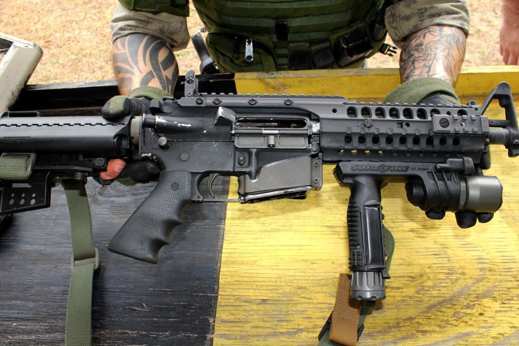

    We were running drills today, one of my students transitioned to his handgun, and finished the drills running his pistol. Once I called the line cold, he called me over to him.
    The bolt was stuck fully to the rear, in the open position. Charging handle was inoperable... Chamber clear, no bolt over brass, etc.
    Bottom line, I could not for the life of me, see what the issue was. In the end, had to disassemble the rifle. Got out my tool kit, took off the stock, castle nut, removed the buffer tube, being careful since the buffer spring was compressed.
    Once I got the buffer tube assembly off the rifle, I pushed the bolt forward and felt resistance. Looking all over the place with my pen light... I found the culprit.
    Primer unseated out of the cartridge, and lodged between the bolt and the upper receiver. Very interesting stoppage... made the MIGHTY COLT stop in it's tracks.

    Intriguing. Thanks for sharing and the pics.
    Would any sort of remedial action have cleared this or was it stuck so stiff that only your disassembly could free the BCG? What brand/type of ammunition was being used? Reloads?

    Did you see where the bind point was?
    Loose primers are notorious for gumming up trigger groups. Tight chambers (non 5.56) increase pressure and exacerbate these issues.

    This is an agency rifle, and the operator was using old M193 (SS109) 5.56 ammo. The cartridge case was stamped for Lake City, and according to the operator, was old training ammo that they brought to "burn up". This ammo was causing several hung cases in the chambers... and was giving light primer strikes on several of the other rifles. It was good, because those running it, were really getting their remedial action drills down pat.
    The stoppage had the BCG locked up so tight, the only way to free it was to remove the buffer tube assembly.
