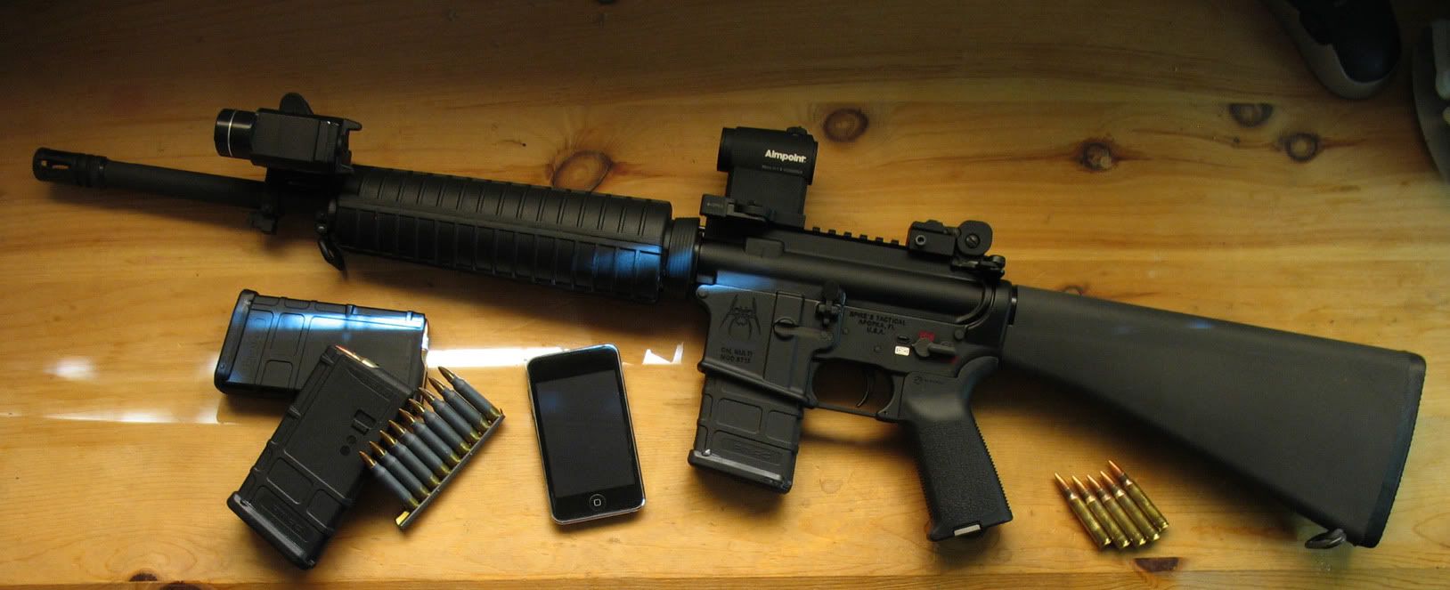

    I am at the range zeroing Speer Gold Dot 64gr (thanks C4I for having it) and I take it off to zero my BUIS at 50yds.
    I put the H-1 and LT660 back on the flattop and the zero is off. By a lot. A couple of inches at 50yds.
    What gives? My four screws securing the H1 to the LT660 are loctited, the securing lever is snug and doesn't wobble.
    Is this to be expected?

    1) Mount in same location yes. Pretty much as far as I can go with it (I'm not getting a cantilever mount). Spikes upper. (And I wish I'd gone with a BCM lightweight 16" mid, but they weren't in stock at the time: especially since Spikes don't clamp their barrels when they torque the barrel nut)
    2) Lever tension was never adjusted by me. Felt snug and fine from the factory.
    3) Windage and/or elevation. It's wierd.
    4) I won't do absolute co-witness. I am only doing the zero without to get a more accurate zero with my BUIS since the A2 front sight post is a bit too thick to see our small targets at 200 to do a confirm zero.
