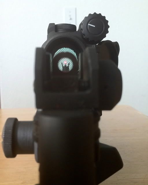

    Anyone have some pics of fixed front and rear BUIS with a normal size aimpoint? Pics through the irons and RDS, I'm curious what this looks like because I don't know anyone in person with such a set up. I'm highly interested in going with fixed sights and an Aimpoint Comp M4 on m next build.

    Quote Originally Posted by Ronin64 View Post
    This was taken from my work rifle. LMT rear and Aimpoint M4 with Killflash in a absolute co-witness LaRue mount. My eyes don't focus like the picture projects - the rear sight blurs out entirely when I'm on target with big peep flipped up.
