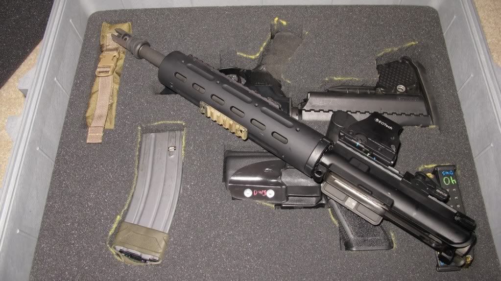

    I just got a Pelican 1600 case in light grey for $150 with two layers of foam. I can put a lower with Emod, two mags (yes, they can be loaded as long as they're "encased" within the bag), holstered Glock 17, two Glock mags, and a bunch of other stuff on the bottom layer, and a 16" upper diagonally across the top layer. The charging handle needs to be removed, unfortunately. I prefer to remove optics when I fly. A 12.5" upper is shown below to show what kind of room you have.
    It's the size of a small/medium suitcase and could be just about anything but a rifle. I got this idea from "m4super90" on 68forums http://68forums.com/forums/showthrea...review-w-pics&
