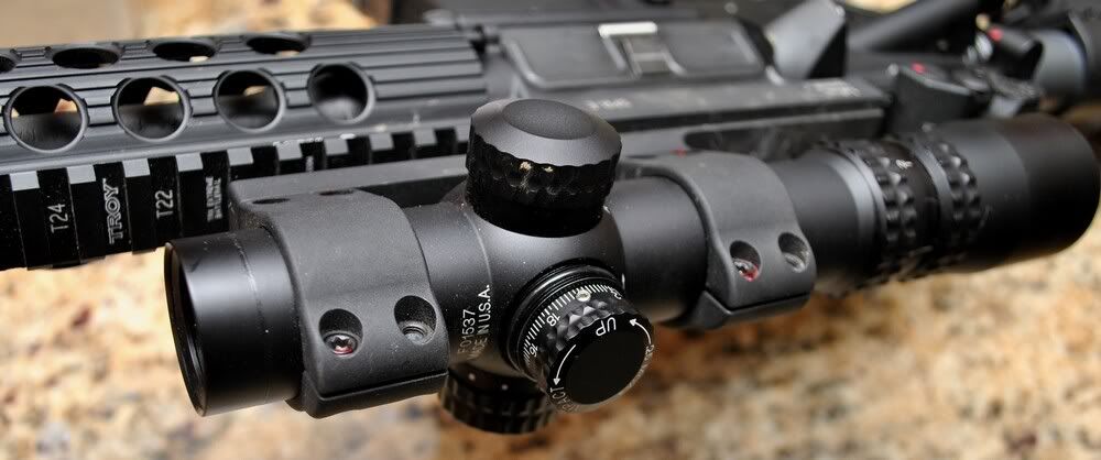

    Quote Originally Posted by CC556 View Post
    I picked up a NXS 1-4 (which is a bit more than the budget stated) and I'm thrilled with it so far over the TR24 (and not just because the NXS isn't full of water.)
    What do you like in particular about the NXS over the TR24?
    How are the adjustments handled on the NXS with the capped turrents? I've never seen a pic of the turrents under the caps.
  5. #25
    Jun 2009
    Bothell, WA
    360
    Quote Originally Posted by bp7178 View Post
    Here's a pic with the elevation cap off:
    I like that the reticle on the NXS (I'm using the FC2) is actually usable for holdovers compared to the TR24 offerings. The NXS gives you an easy 5,10,15 MOA holdover at 4x. There's a bit more eye relief with the NXS as well, which is noticeable when you shoot from different positions. As far as illumination goes, I think the fiber optic illumination is the strong point of the TR24, but I didn't feel any slower shooting with the NXS with the reticle illumination turned off. On the other side of that, in low light when using a flashlight the TR24 illumination pretty much totally washes out, but you can turn up the illumination on the NXS to a usable level.
