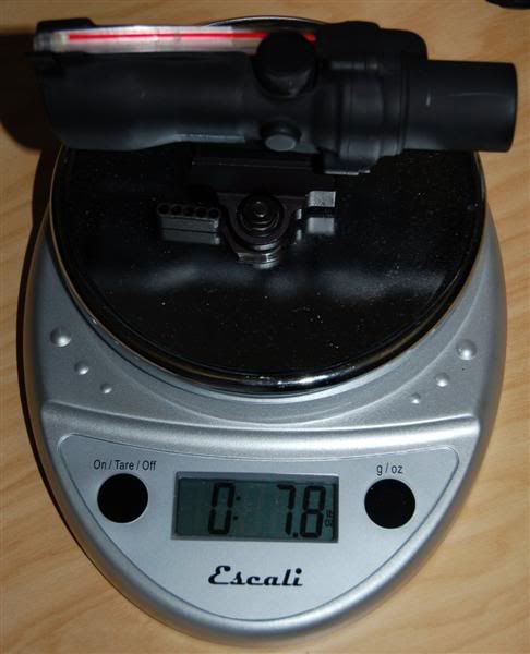

    Another picture from back then. 1.5x in the Larue mount.
