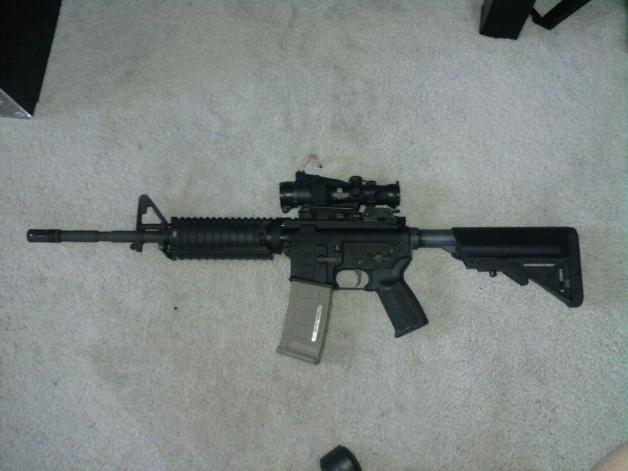

    Yeah went with a 14.5" carbine/pinned flash suppressor and of course that lead to having to put on a quad rail before hand. This was and is my first AR and overall I'm pretty happy with it. Just added some expense up front.
    What I see in the future if I get the urge is to just buy another upper if I see the need or want. I've got sons that will need an AR down the road so another upper is definitely in the future. Would I go with a 14.5" upper again with pinned flash suppressor? No! I would definitely get an SBR and not worry about the pin/welding.
