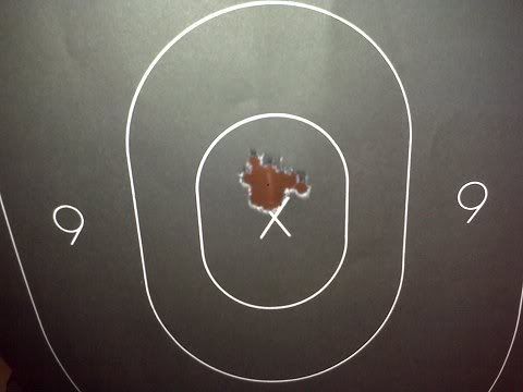

    BCM 16", chrome lined, 1/7 twist, with Remington 55 grain FMJ Wal Mart specials, at 25 yards, with irons. Ten rounds. Add to that the fact that I'm a notoriously lousy shot:
    IMHO, plenty accurate enough.
