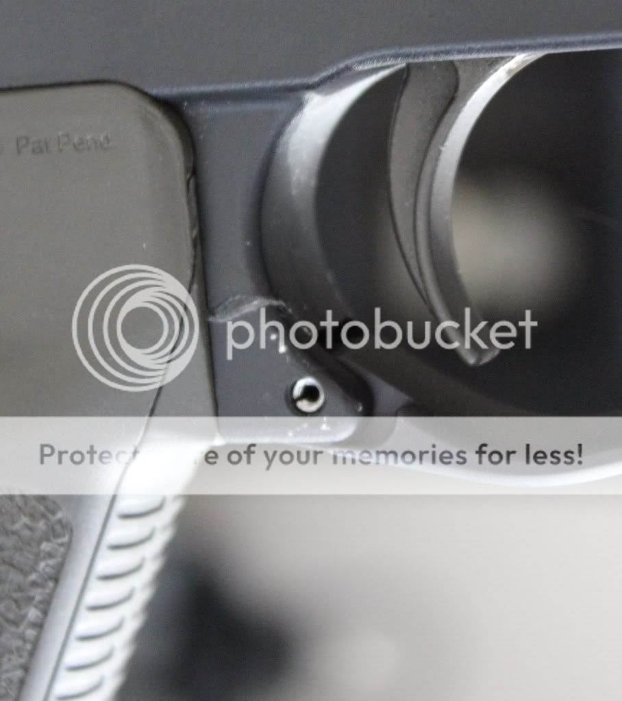

    ive got one to add to the dont build if your and idiot list
    this was one of series of pictures of a rifle for sale on a forum up here, heres the description
    "Now the 'bad' part. Since I'm a total ham-fisted dolt, when installing the Magpul trigger guard, I grabbed the wrong sized pin to drift into the lower. Using a spring punch, I couldn't feel it was wrong until it broke the little 'ear' off the part where it attaches to the trigger guard. Removing my mistake ended up breaking off the OTHER side as well. The little ears are currently crazy-glued back into place, and I've had no issues, but it's not really pretty. "
    "Upper and Lower, no EOTech - $1350 OBO"

    Quote Originally Posted by dudley2112 View Post
    Well to be fair, this mistake is easy to make. Pushing the pins through without supporting the rear of the part will do that. Which I don't know if he read an online instruction that did not stress that enough. But due to the side profile of the AR, that section has to have something directly behind it in order to prevent that from happening. I guess it is so common that my local shop warned me about it.
