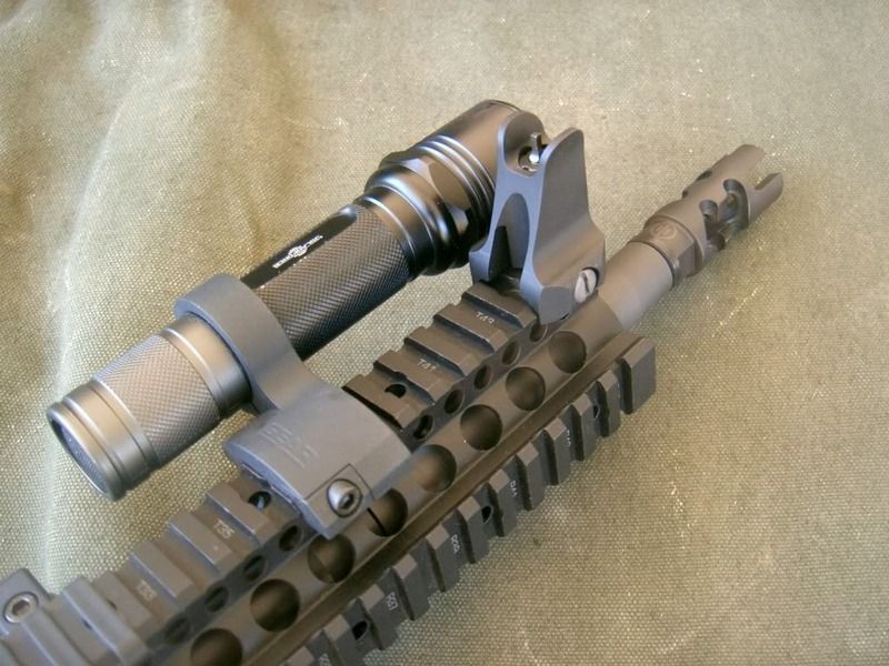

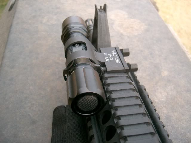

    Which reminds me... the mounts above can place your light in the 11, 2, 4, or 8 o'clock positions.

    Offset mounts can get the light closer to your thumb's natural position on the handguard as well as clearing up your optic's field of view. Both mounts pictured in Markm's post, for example, are offset mounts. Gear Sector, LaRue and VLTOR all manufacture quality products for this application. Viking Tactics also manufactures a very affordable plastic offset mount. I have heard of some people breaking their VTAC mounts when mounting them, though, so I would advise you to purchase an aluminum mount if you can expense it. I highly recommend an offset mount for your G2. If you find that the light interferes with your thumb's natural position when firing, I suggest throwing your thumb over the bore and allowing the tailcap to sit in the webbing of your hand between your thumb and forefinger.
    "Scout" mounts as you said may refer to simpler mounts that put a light directly above a rail, not literally offset at an angle. "Scout" is a term often heard when discussing weaponlights, however, because Surefire manufactures a popular line of expensive, lightweight weaponlights called Scout lights. Scout light mounts are discussed as a result because manufacturers such as Gear Sector and Larue also produce aftermarket Scout series mounts.
