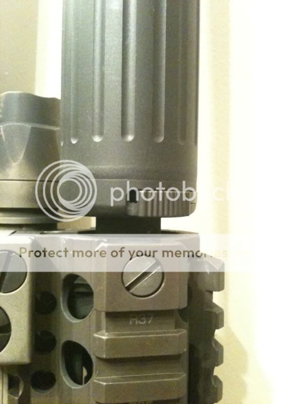

    Wow, that's scary quiet. Do you know if the MK18 was a DD or LMT and what kind of mount he used? I have a DD with a 10.3" barrel and I want to get a 762-SDN-6 with a Brakeout mount, but I'm afraid that the rail will interfere with suppressor clearance.

    Quote Originally Posted by Mahk View Post

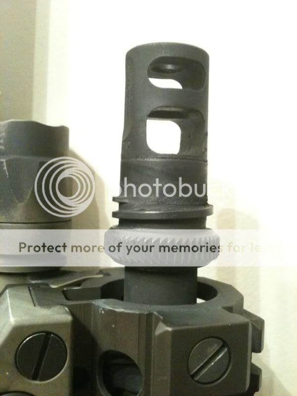

    Excuse the iPhone pics. But I think this might answer your question. I have a LMT 10.5" barrel with the mk18 rail. It's tight but as you can see 10.3" should just clear it. The difference between 10.5" and 10.3" is 3/16". With my AAC 51t brake, the suppressor latch is just a hair over 3/16" from the rail. I think it would look pretty sick on the 10.3". No barrel showing, that's for sure lol
    That was my thought exactly. Either pretty sick or not fit at all haha. My local dealer ordered 9k worth of AAC shit but none of it has come in yet so I can't go test fit as he offered me to do. Do you have any calipers to measure the gap between the back of the can and the rail?
    Mahk-
    The AAC mounts that have a "skirt" or extension behind the ratchet teeth will work with your 10.3 MK18.
    The ones that have a flat back behind the ratchet teeth will not (without a custom-made spacer or a double stack of shims).
    Most Blackout Flash Hiders have this rear extension, and the newer Brakeout comps do too.
    See my handy chart- top hider has the back part, the bottom brakeout does not (but some of the newer ones do).

    Well shit. The problem with running the blackout is that it doesn't have the flat in front of the chamber to act as a sacrificial baffle like the Brakeout and the brake do. I don't want to tear up the suppressor any faster than I already will with the brake by using the flashhider. What a drag.
    I am running a breakout that I got 2 months ago ant it has the skirt. That is were you tighten it wit your wrench. I think if you order one now you will get one with the skirt..
