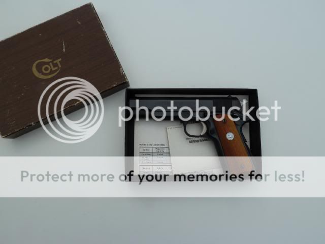

    1911
    Saving this 33 yr old Colt MARK IV series 70 1911 for a smith to work on, otherwise it's my HK45 right now.
    You better send that to me so I can make sure it is safe to have it modified by a 'smith.
