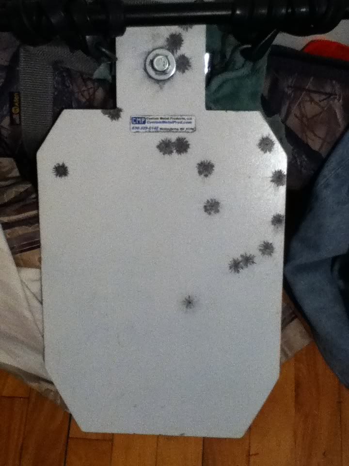

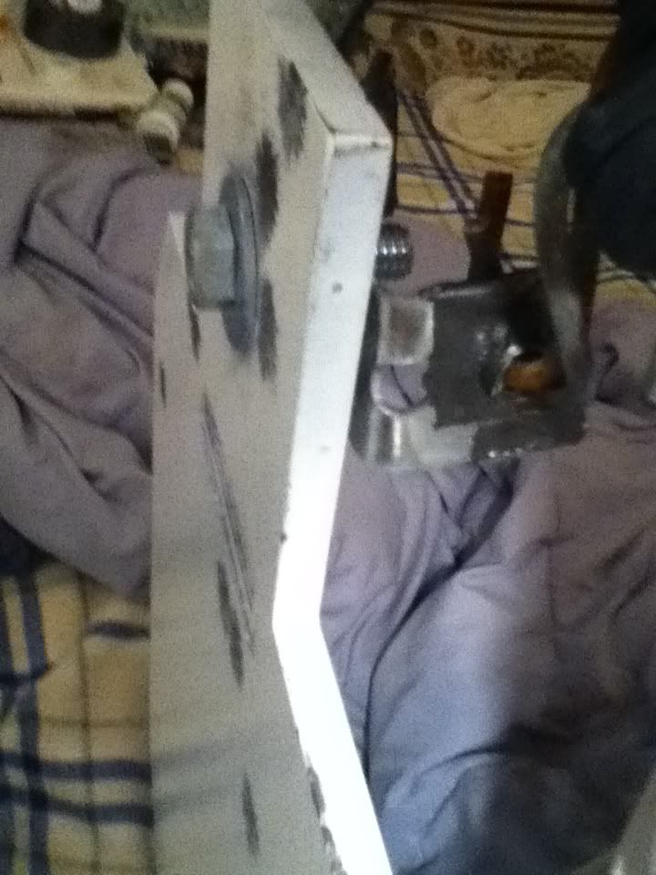

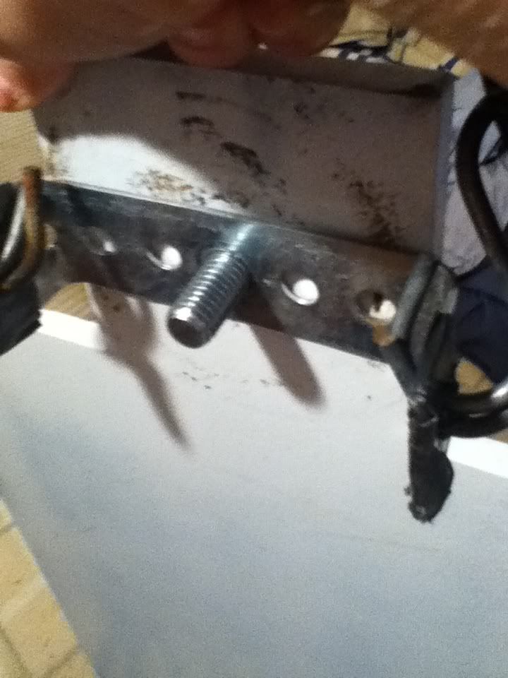

    For now and the foreseeable future, mine is mounted like this:
    I'm just using an expandable metal pole from an old "portable closet/clothes hanger" for the crossbar. The target is hung with 2 toe straps doubled over to raise the height. The stand is just a simple 2x4 sAw horse.
    I put a 1/2" bolt with a washer through the target mounting hole. I bought a 4' strip of "holed sheet metal?" from Lowes for under 5 bucks (see pics). I then cut it to a length that when centered on back of the target it is long enough to allow 2 holes on each side of the "neck" of the target. I then bent the strip 90 degrees on both sides so it is flush with the "neck". Then, of course, I hooked through the rearmost holes in the mounting bar with the tow strap hooks.
    The reason I bent the 2 ends rearward is bc when u connect the tow hooks the weight is off center and forces the target to slightly angle down which CMP recommends for target longevity.
    It seems to be perfect. No matter where the bullet strikes the target is static moments later. I haven't hit super low on it yet but Ive kicked it and it doesn't swing much at all. The only issue is that it's sometimes hard to hear if u hit high on the target but once I got used to what a miss sounded like it became much easier to determine.
    In the pics there is a nut missing that was holding it all together. I guess I need a lock washer or something.
