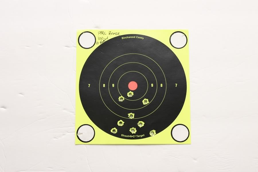

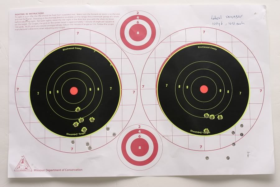

    ~3 MOA seems to be the standard with plinking ammo. I shot these off a bench with a BCM BFH 16" middy and Geissele SSA and Aimpoint M4 w/ 2 MOA dot all at 100 yards.
    PMC .223
    Federal XM193AF
    Prvi Partisan 75gr Match
    Fiocchi Match 77gr Sierra MatchKing
