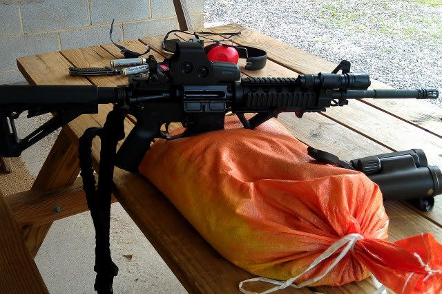

    On May 26th, I was shooting a few rounds with my S&W M&P15A to confirm my iron sight zero after finding the rear sight "loose" during a cleaning. I didn't think there would be a problem but I figured I needed to check.
    I fired 3 rounds with irons only to the body of a B27 target, and for the heck of it thought I'd confirm the EO Tech's zero also. I fired 3 rounds with it to the head of the target. I made the rifle safe, cut the EO Tech off, went downrange, checked these rounds, and returned to fire again.

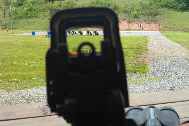

    I fired the 3 rounds with irons only, then shifted to the EO Tech. I pressed the side button, but nothing happened. No reticle.

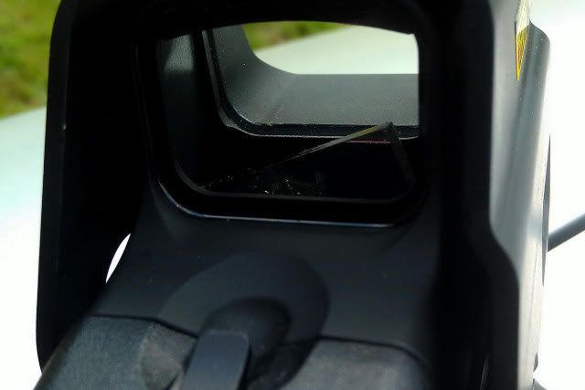

    I pressed again. No reticle. I pressed harder. No reticle. Then I checked the sight, and found the square clear screen (NOT the front or back protective lenses, but apparently an internal "screen") had became dislodged and out of place.
    There was absolutely no way to use the sight. I was admittedly disappointed as their nifty marketing shows them working even after taking bullets through the lenses.
    There is no damage to mine, and no rough handling of the rifle. If not on a sling ON MY PERSON, it rides in a thickly padded case. The model is the 517 (I think) and it is at about the 1200 round mark.

    On Tuesday 5/31 I heard from the CS manager (Michael Kroll) who confirmed the RMA and promised they would fix it. He said my problem was a "detached grating" caused by an assembly error.

    We've seen several go down in local matches, however never seen the glass break like that. Glad to see they took care of you. I've never heard anything bad about the CS. What range is that you're shooting at?
    This wasn't the outer glass-it was the "grating" that actually forms and projects the reticle onto the HUD... It normally rides well down inside the scope, epoxied to the body.
