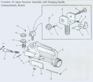

    I have a surplus Colt carry handle and want to order some parts to complete it.
    I've got a handful of parts already.
    2 parts that I think are not interchangeable to the A2 and A3 sights are the elevation knob. (A2 is marked 8/3)
    And the actual rear sight lug, (or rear sight base).
    Though I'm not sure.
    I can't find any dimensions online for the rear sight lug.
    Just exploded view drawings.

    Everything is the same except:
    Rear sight base
    Elevation index
    Elevation knob
    Ball bearing spring

    The set screw is different?
    Which ball bearing spring is different?
    Item number on this drawing?
    Oct 2009
    1,438
    12 (100%)
    Quote Originally Posted by polymorpheous View Post
    Part 3, 13, 15 and 16

    Quote Originally Posted by MK18Pilot View Post
    #14 is the same then?
    Oct 2009
    1,438
    12 (100%)
    Same part...
