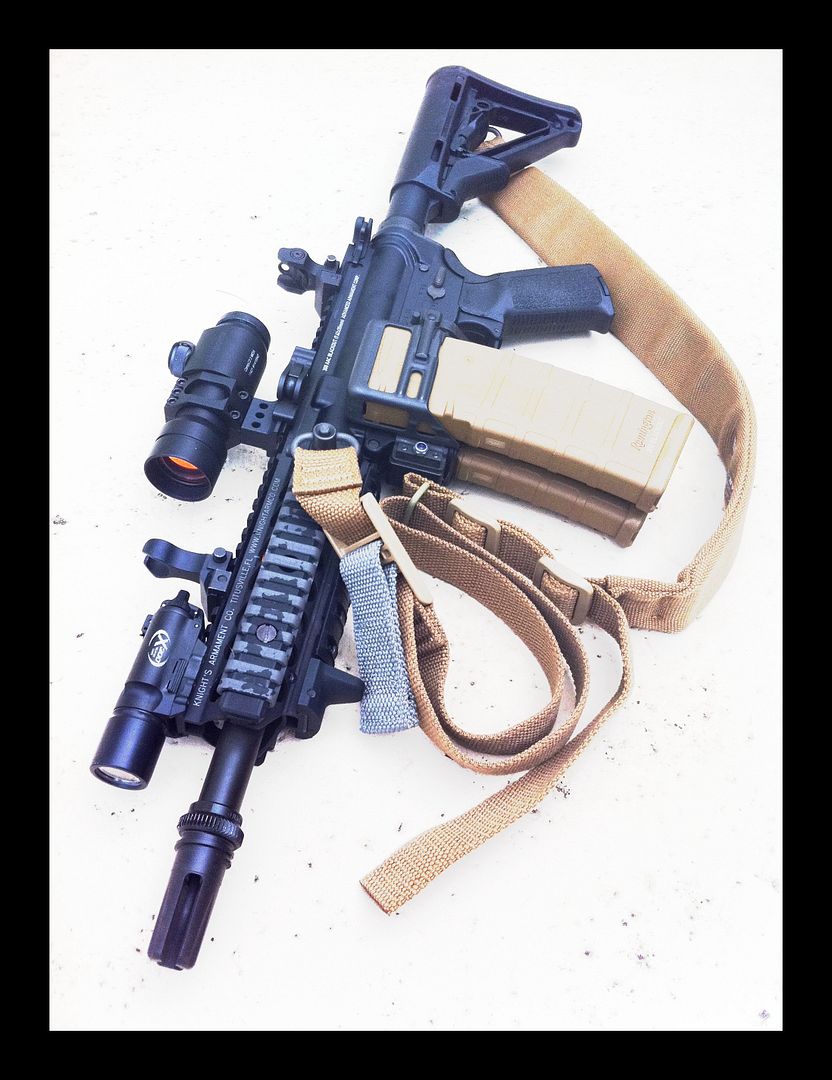

    This is a Centurion Arms 10.5" upper. The FSB is stock and the light is attached via a Gear Sector mount. I have not gotten a chance to shoot this one yet. The upper is a loaner.
    This is an AAC 300 BLK upper. The rail is a KAC (8"?), the barrel is a 9"? and the front sight is a Troy. The extremely short sight radius is a hinderance but it's all I could do given the limits of the rail and the location I wanted for the light. Another loaner.

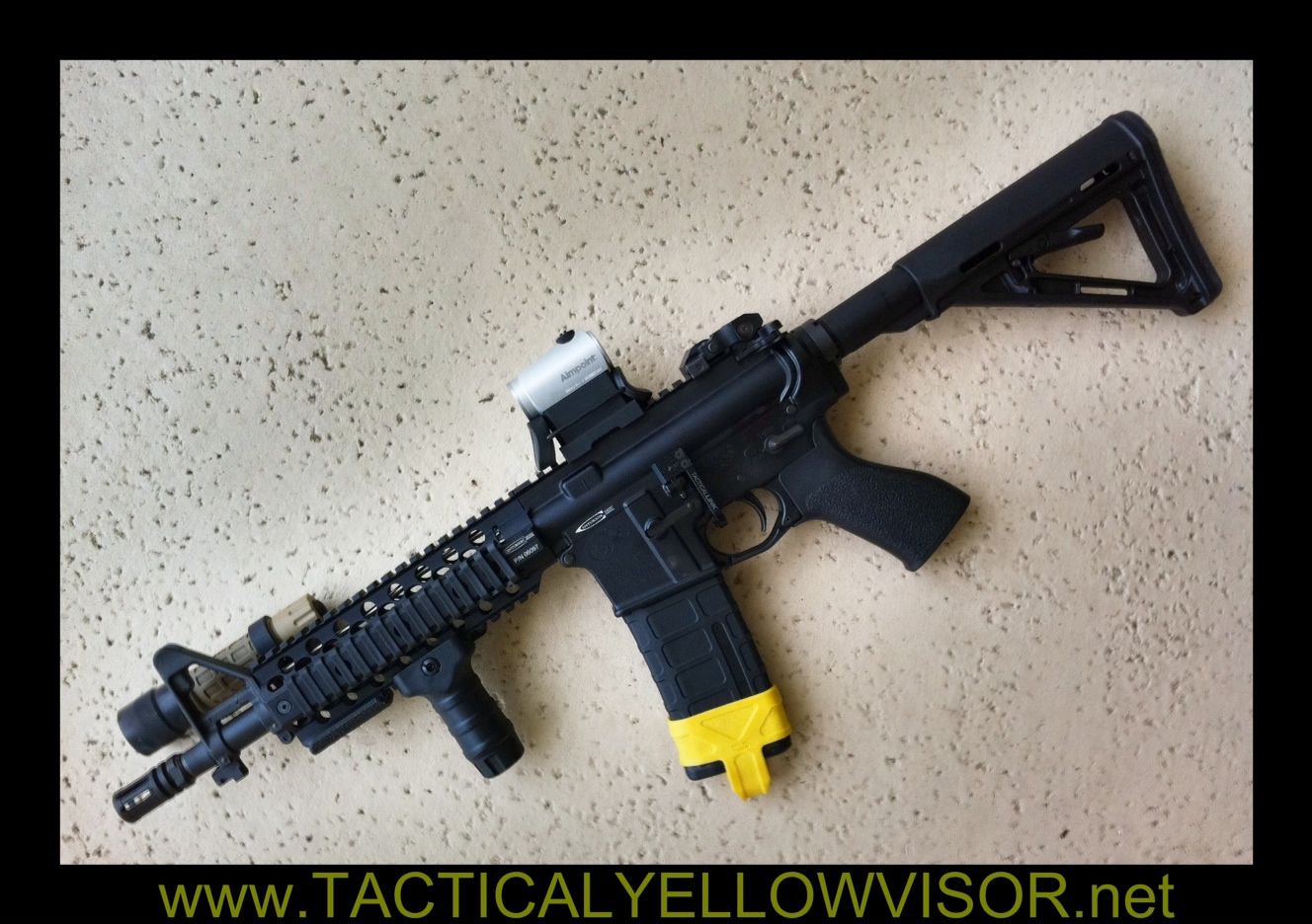

    This is a Colt 6933 with MOE furniture. This is a personal gun. While I'm not shooting that way in the pic, I now find myself shooting with the stock extended further as you describe. If I had no loaner guns tomorrow this is the gun I would shoot 90% of the time. I attach an X300 to the FSB mount by Midwest Industries.
