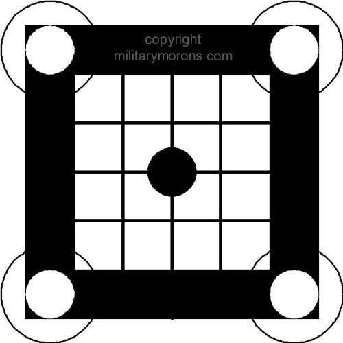

    this is a target that i made up years ago for shooting red dots or magnified optics at. for precision rifle, you have 5 1" dots to aim at. the big black square provides a decent aiming point for unmagnified optics. also works well for handguns.
    download the word document below - the pic above is not the full size version.
