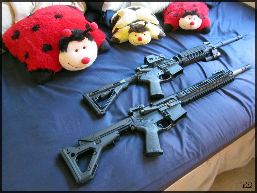

    My rifles. A1 not pictured, obviously :
