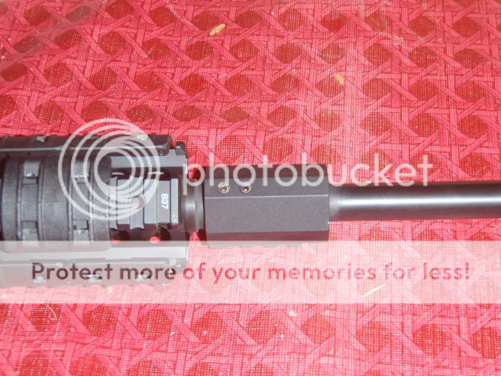

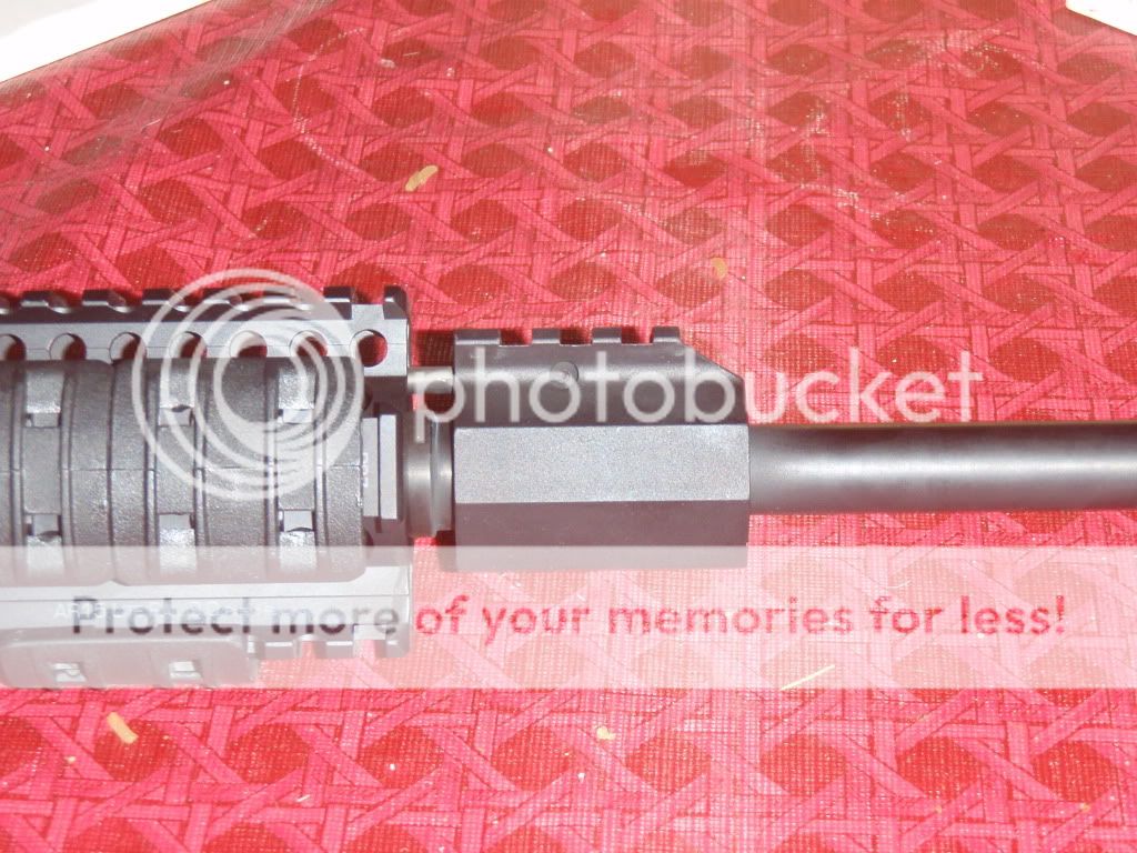

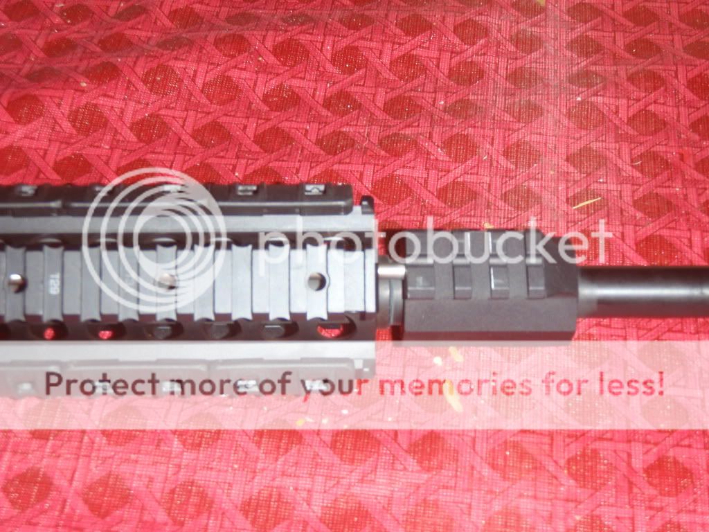

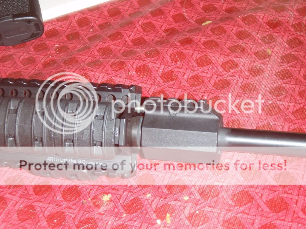

    Quote Originally Posted by QuadBomb View Post
    I think I've found the culprit.
    The gas block is loose. I was able to cant it to either side as far as it would go before the gas tube touched the forearm, just by using my wrist. I took pictures:
    Untouched
    And now, after I twisted it with my hands
    Bottom view
    Top
    Side
    Also, it appears that the gas block has slid forward of its intended position. That rim on the barrel should be flush against the back wall of the gas block, the way I remember it.
    Looks like this one is going back to the shop from whence it came. I hope nothing else happens - this is the second time I've had problems with this upper receiver.
    Untouched
    Bottom view
    Top
    Side

    I hand-cycled it a couple times last night and it had no problems. If I had to guess, manual extraction was difficult because the gas block was out of alignment with the gas port, so the gas system was not working at all when I fired. The BCG was probably driven back and partly unlocked just by the force of recoil.
    At any rate, yes I do intend to have them check the whole thing over. ARP is good about fixing problem weapons but I'd rather not have any more problems at all.

    I just got off the phone with ARP. I described my problem and the guy on the phone told me that sometimes the gas block set screws come loose when the barrel heats up. I told him I've had this upper for nearly a year and I've shot it in a 3-gun match before, never had this problem. "Is that it?" I asked. "Just tighten the screws?" Guy told me yes, just keep on 'em to make sure they are tight.
    I don't know what to make of this, but it doesn't seem good to me. I've never heard of that happening on a well-made AR before. I don't even know what screws he's talking about, I thought the gas block was pinned into place.

    In the photos you posted above, the second one shows the setup from the bottom. Aren't those set screws I see?
    Steve
