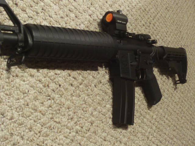

    I figured I would share my new 5.45 ar with you guys, here are the specs (the pictures have already been shown on the pictures thread).
    Specs:
    Spikes Tactical 5.45x39 upper, here is the description off of AIM
    Spikes Tactical 5.45x39 Upper, 16" midlength, complete corrosion Resistant Mid-Length 5.45x39 upper, comes with Wolfe XP hammer spring, and ST-T2 buffer. Lothar Walther barrel, Melonite finish inside and out with Nickel Boron M4 barrel extension. Melonite coated F-marked FSB, Melonite coated gas tube (stainless roll pin), and Melonite coated flash hider (indexed with stainless shims). Nickel Boron BCG.
    Surplus Arms Milspec Lower
    Spikes Tactical nickel boron battle trigger group
    I kick hippies sling mount baseplate
    CMMG lower parts kit
    Magpul MOE pistol grip
    UTG PRO stock set (i am actually very impressed with this piece)
    Magpul MBUS rear sight
    Magpul BAD
    Primary Arms Micro
    Spikes T2 Buffer
    Pics

    So I went out and shot another 500 rounds through it on Saturday. It ran like a champ. The only problem I had with it was with the c-products magazine that came with the upper receiver. When I loaded the magazine to its maximum capacity every 10 or so rounds I would have 2 FTF in a row, then i'd shoot another 10 rounds and get the same results. However when I switched to the AR-Stoner 5.45 magazines I had no issues at all.
    So after that happened 2 times in a row I just tossed the c-products mag to the side and used the AR-stoner mags from that point forward with no further issues. I used the cproducts mag for the first 40 rounds then from that point forward the rest of the 460 rounds were used with the AR stoner mags.
    I was shooting 53 grain Russian military surplus ammo and was getting very similar results that I would with a 5.56 upper. The groups were tight even with the surplus ammo. Since it has a nickel boron BCG and trigger group I decided to run it dry to see how it would do. Everything ran nice and smooth like I was running a fully lubed BCG.
    Overall I am very pleased with how this rifle turned out. On a side note, it appears that Surplus ammo and Spikes Tactical both use Cerro Forge for the uppers/lowers (as marked by the keyhole on both) I noticed immediately that the fit between the upper and lower was wonderful, there is no play between the two of them at all. As soon as the take down pins are in its like one solid mass. Its an awesome combo.
