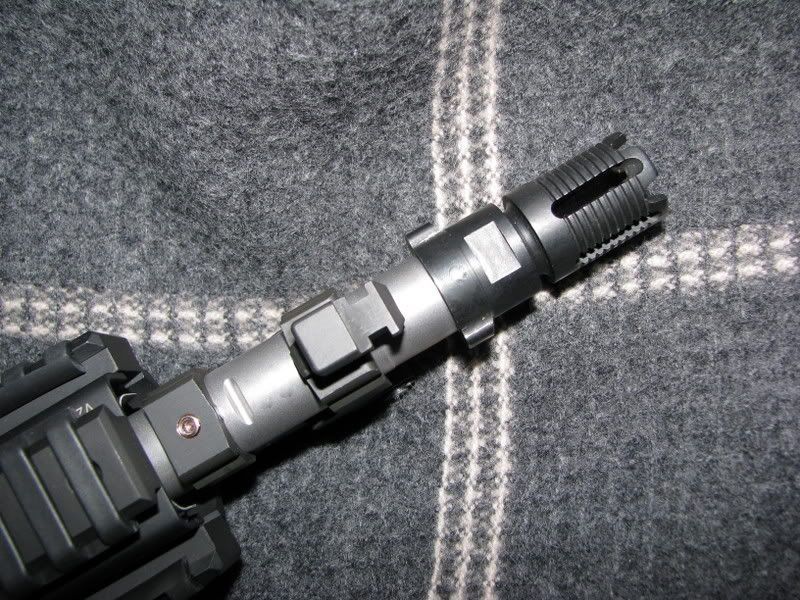

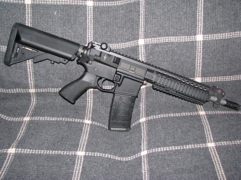

    Like the commercial where the couple goes to the architect, places the Kohler faucet on the table and says "build something around this", I've been looking for something to do with my KAC FS/GB that I've had for over a year. Of course, now it looks like these might not be unobtainium for much longer but that's a good thing because they just rock.

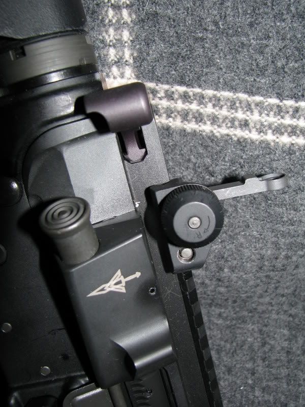

    My gunsmith recently got two Noveske 10.6 CQB barrels in SS AND chrome lined. Very nice for automatic fire. I had a Vltor VIS lying around after scrounging its previous barrel. Add a KAC 300m BUIS, a PRI gasbuster and the awesome Ion Bond BCG from Dennys and ...voila, a very unique and very reliable shorty blaster.
    As my usually iffy luck continued to hold out, my Gemtech can JUST clears the bayonet lug when attaching it. I mean it actually kisses it. Didn't plan for that but thankfully it worked fine.
    This thing is so much fun it's ridiculous. Next up, I just have to have a 7.5" in 6.8 SPC. I'll start looking tomorrow.

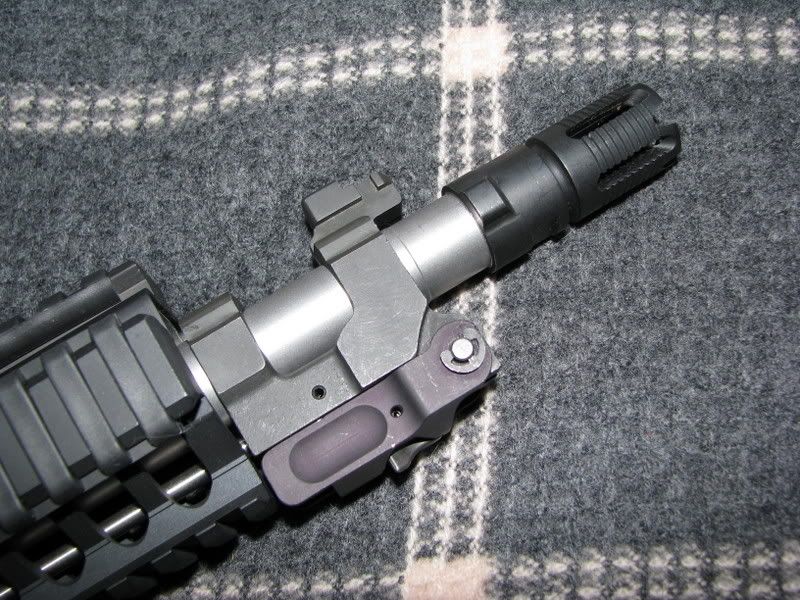

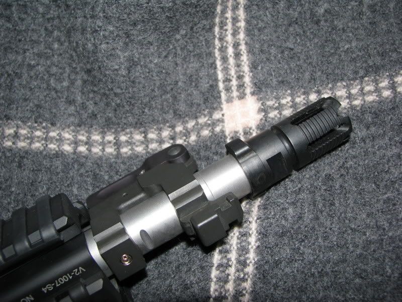

    Sorry, I knew I forgot a couple of pics.
    You can see where the Noveske 17-4 GB was originally cross pinned. The KAC did not line up in the same spot so, using the set screw from the Noveske, the barrel was dimpled and the set screw inserted.
    The GB was also VERY tight and would not go on without the insides being lapped a bit.
    Ideally, you would like both the pins and the set screw but this isn't going anywhere.

    Quote Originally Posted by Lumpy196 View Post
    Nice.
    What optic are you going with?
    For something this compact, I would hate to weigh it down with an big optic. I think this cries out for a LT Iron Dot or an Aimpoint micro.
