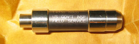

    EDIT:
    Iraqgunz, this would be the one you're talking about, correct?
    Wasn't there a Bill somebody a while back that would regrind the Forster type gauges into the mil type gauge for a fee?

    Quote Originally Posted by GTifosi View Post
    I know of the ones you speak.
    They are turned down, well ground actually, on the end so that there's a round protrusion that is of smaller diameter than what the extractor and ejector pin represent on the bolt face. It just barely covers what area the 'primer circle' ends up on on the face.
    Put them in, run the bolt forward, dump them out manually or suck them out with a stick magnet.
    The Forsters are grooved with an extractor ridge and have a recess hole drilled in them to clear any potential firing pin protrusion, *which isn't present for whatever reason on the above described IIRC.
    The only instance of bolt stripping that Forster mentions in any of thier instructions is in regard to bolt actions.
    It is suggested that the extractor be removed from them to help get a better feel and free-er bolt rotation as the lever arm that the bolt handle represents can do a pretty good job of messing something up if worked too hard due to a numb feel.
    There is no mention anywhere for either bolt action or semi auto action about removing the ejector assembly.
    Their gauges are meant to be used with a fully assembled bolt when working with semi autos.
    If there is concern about the ejector throwing off the gauging, then I'd suggest that the issue is the ejector itself that likely has an issue such as something foreign in its bore or an over long spring or ejector proper preventing free or full movment.
    Basically if the ejector does throw things off, its because it's not being allowed to be compressed down into its hole and flush with the bolt face as it should normally be able to do. Likely it screws up brass and has locking/chambering issues as a result also.
    *it's been more than a couple years since I fondled that type so could be mistaken. But given the smaller diameter of the bolt contact point, it wouldn't make sense to make the gauge more delicate by doing such, especially in a .mil environment.
    EDIT:
    Good pic. That is a GI "Field" headspace gauge. I have checked HS on literaly thousands of M16 series rifles and carbines, and I have only encountered 2 or 3 M16s that failed HS. And those were training rifles with a LOT of rounds on them.
